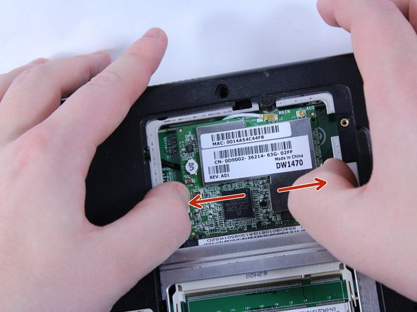

  6. Dell Inspiron B130 RAM and Wireless Replacement: crwdns2935265:06crwdnd2935265:01crwdnd2935265:02crwdne2935265:0 Dell Inspiron B130 RAM and Wireless Replacement: crwdns2935265:06crwdnd2935265:02crwdnd2935265:02crwdne2935265:0
    • To remove the wireless chip, push outward on its two metal brackets.
    • Do not remove the chip just yet, the wire that connects this chip must first be removed.
  7. Dell Inspiron B130 RAM and Wireless Replacement: crwdns2935265:07crwdnd2935265:01crwdnd2935265:02crwdne2935265:0 Dell Inspiron B130 RAM and Wireless Replacement: crwdns2935265:07crwdnd2935265:02crwdnd2935265:02crwdne2935265:0
    • To remove the wire, hold the wireless chip firmly and pull the connection straight up off of the chip.
