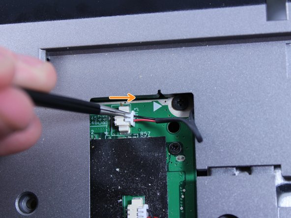

  24. Dell Inspiron B130 Fan Replacement: crwdns2935265:024crwdnd2935265:01crwdnd2935265:02crwdne2935265:0 Dell Inspiron B130 Fan Replacement: crwdns2935265:024crwdnd2935265:02crwdnd2935265:02crwdne2935265:0
    • Disconnect the two connections carefully.
    • Do not pull by the wires! This can damage the connection. Use tweezers to grab by the white plastic piece and push outward.
