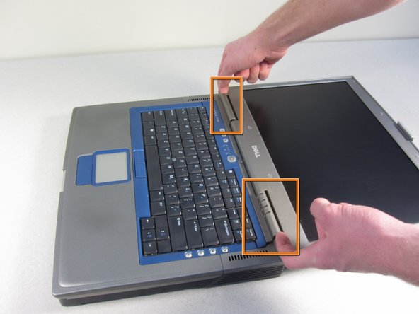

  4. Dell Inspiron 9100 Keyboard Replacement: crwdns2935265:04crwdnd2935265:01crwdnd2935265:03crwdne2935265:0 Dell Inspiron 9100 Keyboard Replacement: crwdns2935265:04crwdnd2935265:02crwdnd2935265:03crwdne2935265:0 Dell Inspiron 9100 Keyboard Replacement: crwdns2935265:04crwdnd2935265:03crwdnd2935265:03crwdne2935265:0

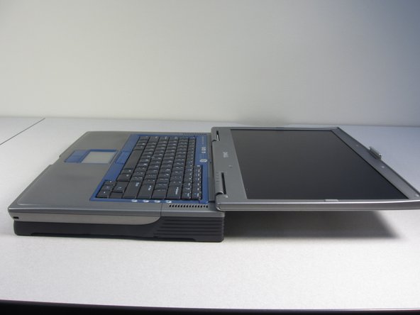

    • Use your fingers to gently pull up on the hinge covers. They will release with an audible snap.
    • Fold the screen back to 180 degrees.
    • Using your index fingers, pull up the hinge cover.
  5. Dell Inspiron 9100 Keyboard Replacement: crwdns2935265:05crwdnd2935265:01crwdnd2935265:03crwdne2935265:0 Dell Inspiron 9100 Keyboard Replacement: crwdns2935265:05crwdnd2935265:02crwdnd2935265:03crwdne2935265:0 Dell Inspiron 9100 Keyboard Replacement: crwdns2935265:05crwdnd2935265:03crwdnd2935265:03crwdne2935265:0
    • After the hinges pop, pull the hinge cover gently.
    • Pull the clear tab on the right side of the laptop up. This tab will disconnect the hinge cover from the laptop.
