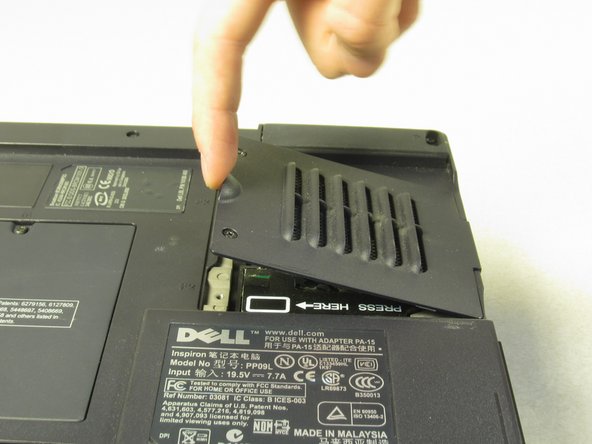

    • Unplug the laptop from the power adapter and turn the power off.
    • Failure to unplug laptop before proceeding could result in risk of electric shock!
  2. Dell Inspiron 9100 Fan 2 Replacement: crwdns2935265:02crwdnd2935265:01crwdnd2935265:03crwdne2935265:0 Dell Inspiron 9100 Fan 2 Replacement: crwdns2935265:02crwdnd2935265:02crwdnd2935265:03crwdne2935265:0 Dell Inspiron 9100 Fan 2 Replacement: crwdns2935265:02crwdnd2935265:03crwdnd2935265:03crwdne2935265:0
    • Slide the battery-lock tab and hold.
    • Flip the battery away from the chassis to remove it.
  3. Dell Inspiron 9100 Fan 2 Replacement, Fan 2: crwdns2935265:03crwdnd2935265:01crwdnd2935265:02crwdne2935265:0 Dell Inspiron 9100 Fan 2 Replacement, Fan 2: crwdns2935265:03crwdnd2935265:02crwdnd2935265:02crwdne2935265:0
    • Undo the two screws on the fan cover labeled "F2"
    • These screws will remain in the panel
    • Remove cover plate.
  4. Dell Inspiron 9100 Fan 2 Replacement: crwdns2935265:04crwdnd2935265:01crwdnd2935265:01crwdne2935265:0
    • Remove the single 6mm screw holding the fan in place.
  5. Dell Inspiron 9100 Fan 2 Replacement: crwdns2935265:05crwdnd2935265:01crwdnd2935265:02crwdne2935265:0 Dell Inspiron 9100 Fan 2 Replacement: crwdns2935265:05crwdnd2935265:02crwdnd2935265:02crwdne2935265:0
    • Flip the handle up.
    • Use the handle to pull the fan away directly up, away from case.
