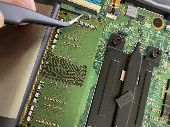

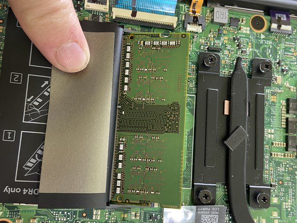

  5. Dell Inspiron 7573 2-in-1 Memory Modules (RAM) Replacement, Memory Modules: crwdns2935265:05crwdnd2935265:01crwdnd2935265:02crwdne2935265:0 Dell Inspiron 7573 2-in-1 Memory Modules (RAM) Replacement, Memory Modules: crwdns2935265:05crwdnd2935265:02crwdnd2935265:02crwdne2935265:0
    • Peel back the mylar coverings on the RAM chips on the right side of the system board.
  6. Dell Inspiron 7573 2-in-1 Memory Modules (RAM) Replacement: crwdns2935265:06crwdnd2935265:01crwdnd2935265:03crwdne2935265:0 Dell Inspiron 7573 2-in-1 Memory Modules (RAM) Replacement: crwdns2935265:06crwdnd2935265:02crwdnd2935265:03crwdne2935265:0 Dell Inspiron 7573 2-in-1 Memory Modules (RAM) Replacement: crwdns2935265:06crwdnd2935265:03crwdnd2935265:03crwdne2935265:0
    • Push outward on the two gray tabs on either side of the RAM module.
    • These tabs hold down the RAM modules, which should pop up when disengaged.
    • Gently pull the memory module out of its slot.
    • Be sure to only touch the edges of the RAM module, as the oil from your fingers can damage the components on the face.

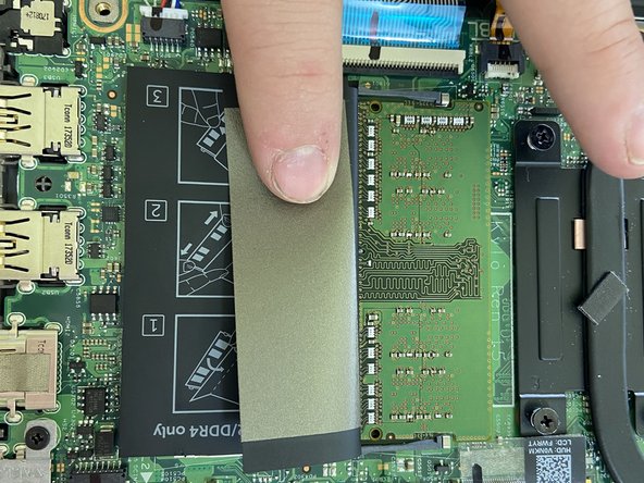

  8. Dell Inspiron 7573 2-in-1 Memory Modules (RAM) Replacement: crwdns2935265:08crwdnd2935265:01crwdnd2935265:01crwdne2935265:0
    • Repeat steps 5-7 for the other memory module.
    • In this laptop, one set of tabs was gray plastic and the other was metallic.
    • When pushing down on the memory modules, make sure you hear a click.
