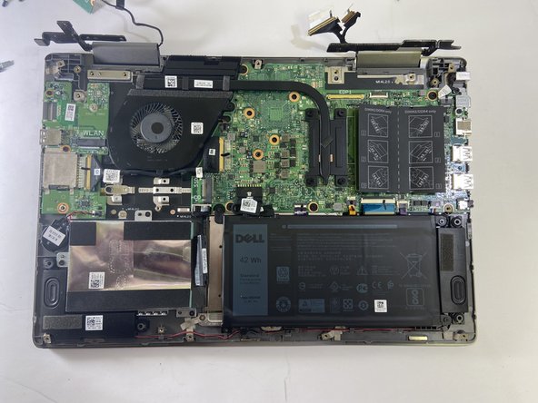

  3. Dell Inspiron 7573 2-in-1 Hinge Replacement: crwdns2935265:03crwdnd2935265:01crwdnd2935265:01crwdne2935265:0
    • Remove the four 3 mm screws holding the battery in place with a Phillips #00 screwdriver.
  4. Dell Inspiron 7573 2-in-1 Hinge Replacement: crwdns2935265:04crwdnd2935265:01crwdnd2935265:03crwdne2935265:0 Dell Inspiron 7573 2-in-1 Hinge Replacement: crwdns2935265:04crwdnd2935265:02crwdnd2935265:03crwdne2935265:0 Dell Inspiron 7573 2-in-1 Hinge Replacement: crwdns2935265:04crwdnd2935265:03crwdnd2935265:03crwdne2935265:0
    • Using the pull tab, disconnect the battery cable from the system board.
    • Lift the battery out from the laptop case.

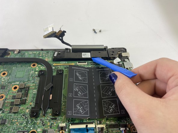

  6. Dell Inspiron 7573 2-in-1 Hinge Replacement, Hinges: crwdns2935265:06crwdnd2935265:01crwdnd2935265:03crwdne2935265:0 Dell Inspiron 7573 2-in-1 Hinge Replacement, Hinges: crwdns2935265:06crwdnd2935265:02crwdnd2935265:03crwdne2935265:0 Dell Inspiron 7573 2-in-1 Hinge Replacement, Hinges: crwdns2935265:06crwdnd2935265:03crwdnd2935265:03crwdne2935265:0
    • Peel off the tapes that secure the display cable and touch-screen board cable to the system board.
    • Open the latches and disconnect the display cable and the touch-screen board cable from the system board.
  7. Dell Inspiron 7573 2-in-1 Hinge Replacement: crwdns2935265:07crwdnd2935265:01crwdnd2935265:03crwdne2935265:0 Dell Inspiron 7573 2-in-1 Hinge Replacement: crwdns2935265:07crwdnd2935265:02crwdnd2935265:03crwdne2935265:0 Dell Inspiron 7573 2-in-1 Hinge Replacement: crwdns2935265:07crwdnd2935265:03crwdnd2935265:03crwdne2935265:0
    • Remove the seven 2 mm screws that secure the display assembly hinges to the palm-rest assembly with a Phillips #00 screwdriver.
    • Use a plastic opening tool to gently lift up the hinges if they are difficult to move.

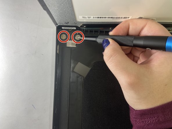

  10. Dell Inspiron 7573 2-in-1 Hinge Replacement: crwdns2935265:010crwdnd2935265:01crwdnd2935265:02crwdne2935265:0 Dell Inspiron 7573 2-in-1 Hinge Replacement: crwdns2935265:010crwdnd2935265:02crwdnd2935265:02crwdne2935265:0
    • Remove four 2 mm Phillips #00 screws behind the screen display.
