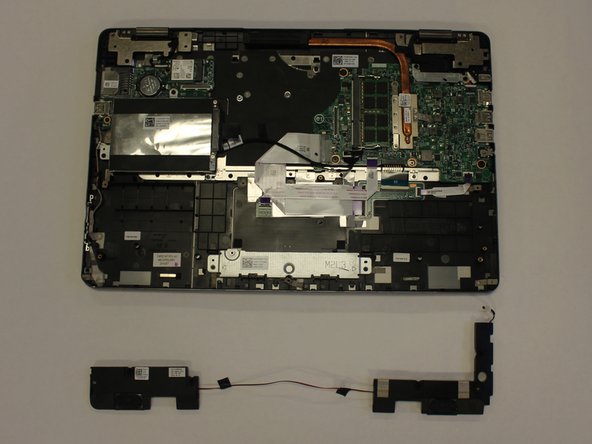

  3. Dell Inspiron 7568 Trackpad Replacement Guide, Track Pad: crwdns2935265:03crwdnd2935265:01crwdnd2935265:02crwdne2935265:0 Dell Inspiron 7568 Trackpad Replacement Guide, Track Pad: crwdns2935265:03crwdnd2935265:02crwdnd2935265:02crwdne2935265:0
    • Unplug the speaker cable and remove the speakers
  4. Dell Inspiron 7568 Trackpad Replacement Guide: crwdns2935265:04crwdnd2935265:01crwdnd2935265:02crwdne2935265:0 Dell Inspiron 7568 Trackpad Replacement Guide: crwdns2935265:04crwdnd2935265:02crwdnd2935265:02crwdne2935265:0
    • Unscrew & remove the two 3mm screws (using a ph1 screwdriver bit) holding the touchpad bracket
    • Remove the touchpad bracket

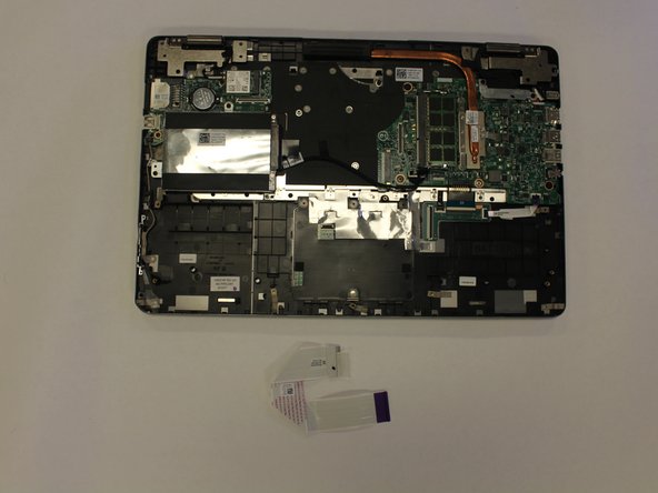

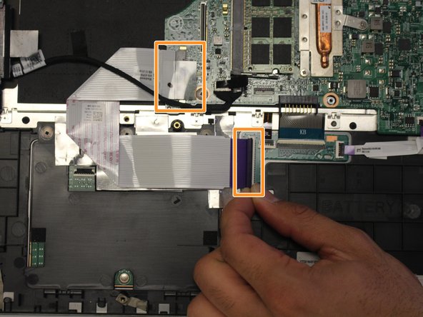

  5. Dell Inspiron 7568 Trackpad Replacement Guide: crwdns2935265:05crwdnd2935265:01crwdnd2935265:03crwdne2935265:0 Dell Inspiron 7568 Trackpad Replacement Guide: crwdns2935265:05crwdnd2935265:02crwdnd2935265:03crwdne2935265:0 Dell Inspiron 7568 Trackpad Replacement Guide: crwdns2935265:05crwdnd2935265:03crwdnd2935265:03crwdne2935265:0
    • Use a nylon spudger to lift the ZIF connector tab. Gently pull the touchpad ribbon cable free.
    • Use a nylon spudger to lift the ZIF connector tab. Gently pull the keyboard daughter board ribbon cable free.
  6. Dell Inspiron 7568 Trackpad Replacement Guide: crwdns2935265:06crwdnd2935265:01crwdnd2935265:03crwdne2935265:0 Dell Inspiron 7568 Trackpad Replacement Guide: crwdns2935265:06crwdnd2935265:02crwdnd2935265:03crwdne2935265:0 Dell Inspiron 7568 Trackpad Replacement Guide: crwdns2935265:06crwdnd2935265:03crwdnd2935265:03crwdne2935265:0
    • Remove the touchpad foil using a spudger or other ESD safe blunt-tip tool.
    • Unscrew & remove the three 2mm wafer screws holding the touchpad.
    • Remove the touchpad.
