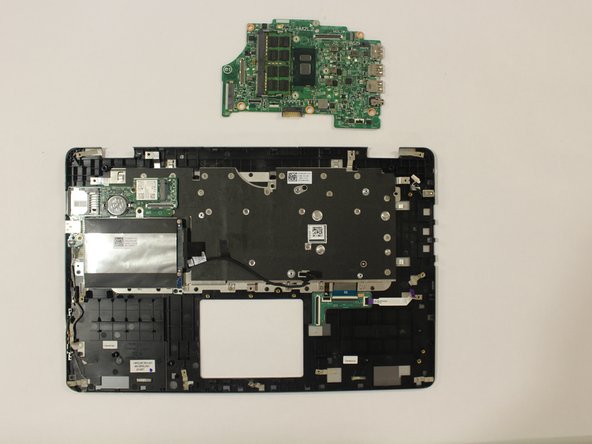

  9. Dell Inspiron 7568 Keyboard Replacement Guide, Keyboard: crwdns2935265:09crwdnd2935265:01crwdnd2935265:03crwdne2935265:0 Dell Inspiron 7568 Keyboard Replacement Guide, Keyboard: crwdns2935265:09crwdnd2935265:02crwdnd2935265:03crwdne2935265:0 Dell Inspiron 7568 Keyboard Replacement Guide, Keyboard: crwdns2935265:09crwdnd2935265:03crwdnd2935265:03crwdne2935265:0
    • Once the battery, screen, cooling fan, trackpad are out, the device would resemble the one in the first picture of this step.
    • Unscrew the three screws connecting the copper pipe to the motherboard.
    • Remove the copper pipe.

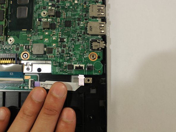

  10. Dell Inspiron 7568 Keyboard Replacement Guide: crwdns2935265:010crwdnd2935265:01crwdnd2935265:03crwdne2935265:0 Dell Inspiron 7568 Keyboard Replacement Guide: crwdns2935265:010crwdnd2935265:02crwdnd2935265:03crwdne2935265:0 Dell Inspiron 7568 Keyboard Replacement Guide: crwdns2935265:010crwdnd2935265:03crwdnd2935265:03crwdne2935265:0
    • Unscrew the three 2mm wafer screws holding the motherboard.
    • Unplug the DC cable from the motherboard.
  11. Dell Inspiron 7568 Keyboard Replacement Guide: crwdns2935265:011crwdnd2935265:01crwdnd2935265:02crwdne2935265:0 Dell Inspiron 7568 Keyboard Replacement Guide: crwdns2935265:011crwdnd2935265:02crwdnd2935265:02crwdne2935265:0

  12. Dell Inspiron 7568 Keyboard Replacement Guide: crwdns2935265:012crwdnd2935265:01crwdnd2935265:03crwdne2935265:0 Dell Inspiron 7568 Keyboard Replacement Guide: crwdns2935265:012crwdnd2935265:02crwdnd2935265:03crwdne2935265:0 Dell Inspiron 7568 Keyboard Replacement Guide: crwdns2935265:012crwdnd2935265:03crwdnd2935265:03crwdne2935265:0
    • Unplug the hard-drive cable
    • Remove the motherboard

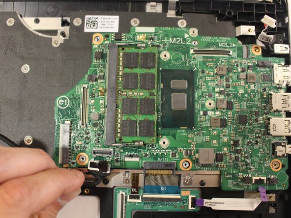

    • Unscrew & remove the sixteen 2mm screws holding the keyboard (using a PH000 screwdriver bit)
  17. Dell Inspiron 7568 Keyboard Replacement Guide: crwdns2935265:017crwdnd2935265:01crwdnd2935265:03crwdne2935265:0 Dell Inspiron 7568 Keyboard Replacement Guide: crwdns2935265:017crwdnd2935265:02crwdnd2935265:03crwdne2935265:0 Dell Inspiron 7568 Keyboard Replacement Guide: crwdns2935265:017crwdnd2935265:03crwdnd2935265:03crwdne2935265:0
    • Unplug the keyboard ("KB") and backlight ("BL") cable
    • Remove the keyboard.
