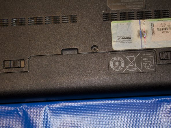

    • Turn over laptop .Remove battery from laptop by pushing the two tabs are highlighted in blue. Place the battery off to the side.

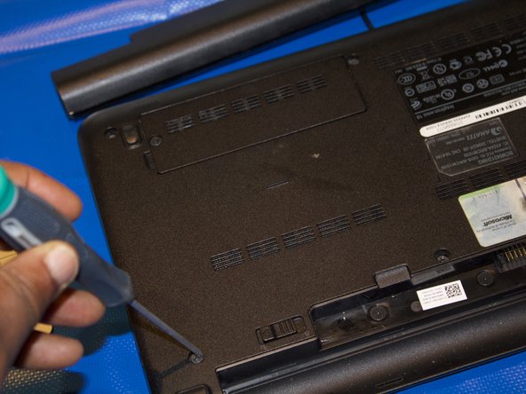

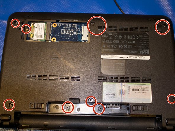

    • Remove the 3 screws highlighted in red that secure the keyboard to the case using the screwdriver with largest phillips head in the box. Make

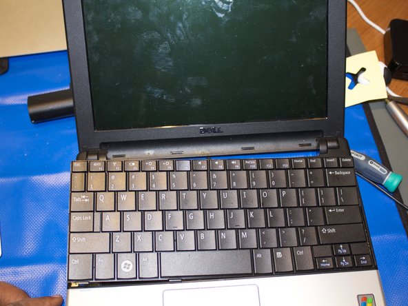

    • Turn the device right side up and open the device to view the keyboard.
    • Remove the keyboard away from the case ,using a plastic spudger if necessary.

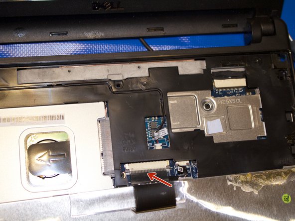

    • The keyboard will still be attached to the motherboard by a ribbon cable.

    • Replace the new keyboard with plastic spudger.
    • The keyboard will have to be attached to the motherboard by a ribbon cable.
    • Snapped the keyboard back in place.

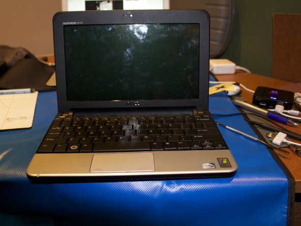

    • Flip over the laptop
    • Put the screws back in laptop
  6. Dell Inspiron 6400 keyboard Replacement: crwdns2935265:06crwdnd2935265:01crwdnd2935265:02crwdne2935265:0 Dell Inspiron 6400 keyboard Replacement: crwdns2935265:06crwdnd2935265:02crwdnd2935265:02crwdne2935265:0
    • Place the battery and lock it into place
