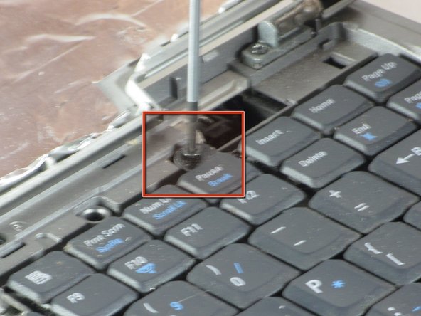

    • Caution the face plate is a fragile piece of plastic. Handle carefully.
    • Start in the upper right corner and work to the left when removing the face plate (includes power button and volume controls).
    • Use a flathead screwdriver (or anything flat and strong) to wedge underneath the face plate.
    • Carefully lift the screwdriver to remove the face plate.

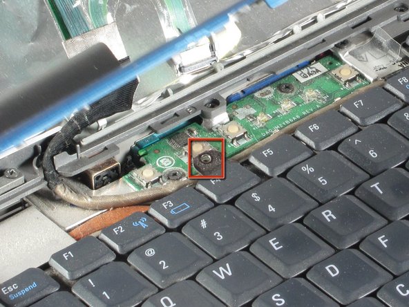

    • Use a the Phillips screwdriver to remove the two screws.
