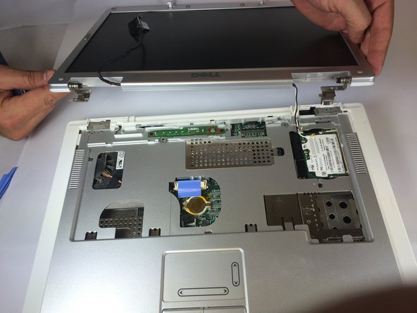

    1. Dell Inspiron 6000 Fan Replacement, Fan: crwdns2935265:07crwdnd2935265:01crwdnd2935265:01crwdne2935265:0
      • Unscrew the 4 mm Phillips #00 screw.
      • The screw will remain attached to the cord when fully removed.
    2. Dell Inspiron 6000 Fan Replacement: crwdns2935265:08crwdnd2935265:01crwdnd2935265:02crwdne2935265:0 Dell Inspiron 6000 Fan Replacement: crwdns2935265:08crwdnd2935265:02crwdnd2935265:02crwdne2935265:0
      • Gently pull the blue tab to separate the screen connection from the laptop.
      • Gently pull and disconnect the white and black cords from the power source.
    3. Dell Inspiron 6000 Fan Replacement: crwdns2935265:09crwdnd2935265:01crwdnd2935265:02crwdne2935265:0 Dell Inspiron 6000 Fan Replacement: crwdns2935265:09crwdnd2935265:02crwdnd2935265:02crwdne2935265:0
      • Remove four 4mm #00 Philips screws from the screen hinges.
      • Lift the screen away from the laptop.
    4. Dell Inspiron 6000 Fan Replacement: crwdns2935265:010crwdnd2935265:01crwdnd2935265:02crwdne2935265:0 Dell Inspiron 6000 Fan Replacement: crwdns2935265:010crwdnd2935265:02crwdnd2935265:02crwdne2935265:0
      • Remove two 4 mm Philips #00 screws that connect top of laptop to base..
