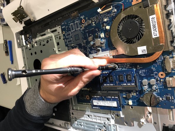

  19. Dell Inspiron 5758 Heatsink and Fan Replacement, Heatsink and Fan: crwdns2935265:019crwdnd2935265:01crwdnd2935265:01crwdne2935265:0
    • After removing the bottom base, you can access the heatsink and fan, which is attached to the motherboard.
  20. Dell Inspiron 5758 Heatsink and Fan Replacement: crwdns2935265:020crwdnd2935265:01crwdnd2935265:03crwdne2935265:0 Dell Inspiron 5758 Heatsink and Fan Replacement: crwdns2935265:020crwdnd2935265:02crwdnd2935265:03crwdne2935265:0 Dell Inspiron 5758 Heatsink and Fan Replacement: crwdns2935265:020crwdnd2935265:03crwdnd2935265:03crwdne2935265:0
    • Unplug the cable that connects the heatsink and fan to the motherboard.
  21. Dell Inspiron 5758 Heatsink and Fan Replacement: crwdns2935265:021crwdnd2935265:01crwdnd2935265:02crwdne2935265:0 Dell Inspiron 5758 Heatsink and Fan Replacement: crwdns2935265:021crwdnd2935265:02crwdnd2935265:02crwdne2935265:0
    • Loosen the three 5mm screws that connect the heatsink and fan to the motherboard.
    • The screws stay attached to the heatsink and fan. You cannot pull them out, only loosen them.
  22. Dell Inspiron 5758 Heatsink and Fan Replacement: crwdns2935265:022crwdnd2935265:01crwdnd2935265:03crwdne2935265:0 Dell Inspiron 5758 Heatsink and Fan Replacement: crwdns2935265:022crwdnd2935265:02crwdnd2935265:03crwdne2935265:0 Dell Inspiron 5758 Heatsink and Fan Replacement: crwdns2935265:022crwdnd2935265:03crwdnd2935265:03crwdne2935265:0
    • Remove the heatsink and fan from the motherboard. You can now clean or replace it as you see fit.
