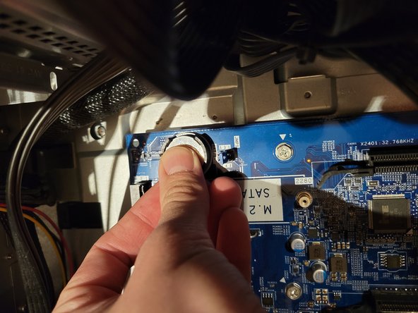

  4. Dell Inspiron 5675 CMOS Battery Replacement: crwdns2935265:04crwdnd2935265:01crwdnd2935265:03crwdne2935265:0 Dell Inspiron 5675 CMOS Battery Replacement: crwdns2935265:04crwdnd2935265:02crwdnd2935265:03crwdne2935265:0 Dell Inspiron 5675 CMOS Battery Replacement: crwdns2935265:04crwdnd2935265:03crwdnd2935265:03crwdne2935265:0
    • The CMOS battery is located on the motherboard, just below the M.2 SATA SSD slot. Use your thumb and nail to pull out the battery from its slot.

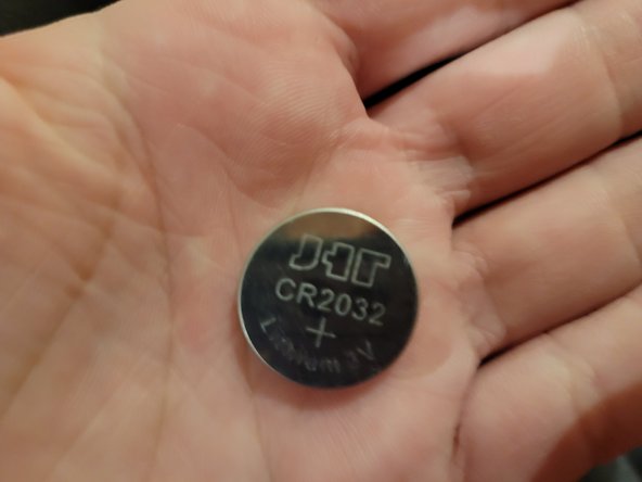

  5. Dell Inspiron 5675 CMOS Battery Replacement: crwdns2935265:05crwdnd2935265:01crwdnd2935265:03crwdne2935265:0 Dell Inspiron 5675 CMOS Battery Replacement: crwdns2935265:05crwdnd2935265:02crwdnd2935265:03crwdne2935265:0 Dell Inspiron 5675 CMOS Battery Replacement: crwdns2935265:05crwdnd2935265:03crwdnd2935265:03crwdne2935265:0
    • After it's removed, grab the replacement battery.
    • Slide half the battery in the slot and use your thumb to push it down.
    • Once you hear a click or see its in place, it has been replaced.
