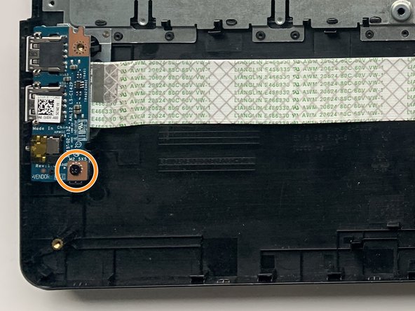

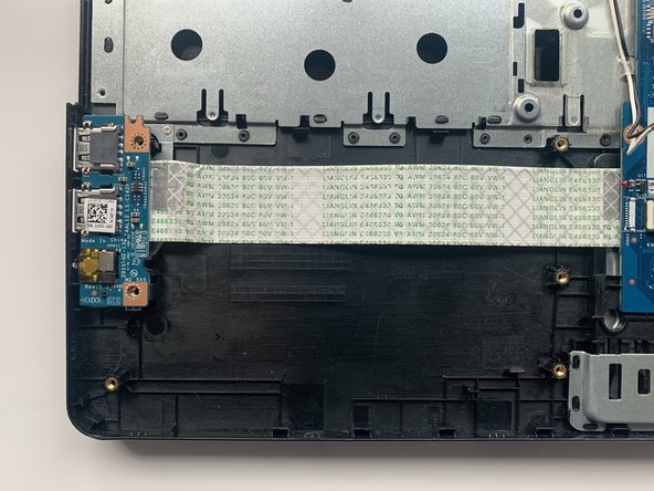

    • Remove the 5 mm screw from the circuit board using the Phillips #0 screwdriver.
    • Loosen the circuit by lifting it up from the device.
    • The white and green cable will remain attached to the circuit board on the left end and attached to the motherboard on the right end.

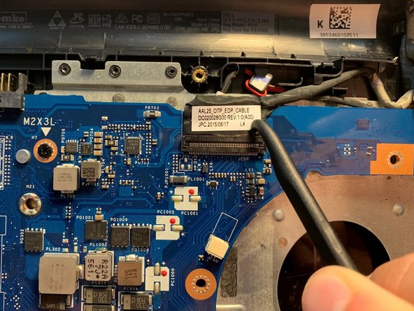

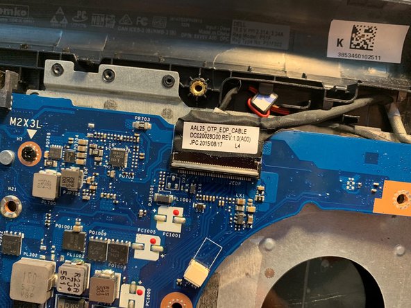

    • Using the halberd spudger, pull back and up to lift the black tab that holds the LCD cable in place.
    • Pull the LCD cable out with your fingers.

    • Remove the 3 mm screw using the Phillips #0 screwdriver.
    • Carefully lift the motherboard and circuit board and turn it over.
    • The motherboard is still connected to the device so be careful to not yank up on it.
  22. Dell Inspiron 5555 Motherboard Replacement: crwdns2935265:022crwdnd2935265:01crwdnd2935265:03crwdne2935265:0 Dell Inspiron 5555 Motherboard Replacement: crwdns2935265:022crwdnd2935265:02crwdnd2935265:03crwdne2935265:0 Dell Inspiron 5555 Motherboard Replacement: crwdns2935265:022crwdnd2935265:03crwdnd2935265:03crwdne2935265:0

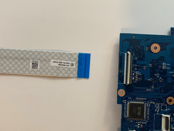

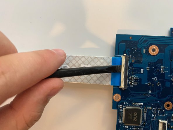

    • Using the flat end of the spudger, lift the white tab holding the USB circuit board cable attached to the motherboard to detach it from the motherboard.
  23. Dell Inspiron 5555 Motherboard Replacement: crwdns2935265:023crwdnd2935265:01crwdnd2935265:03crwdne2935265:0 Dell Inspiron 5555 Motherboard Replacement: crwdns2935265:023crwdnd2935265:02crwdnd2935265:03crwdne2935265:0 Dell Inspiron 5555 Motherboard Replacement: crwdns2935265:023crwdnd2935265:03crwdnd2935265:03crwdne2935265:0
    • Use your fingers to pull the DC jack cable out of its port, separating the motherboard from the rest of the device.
