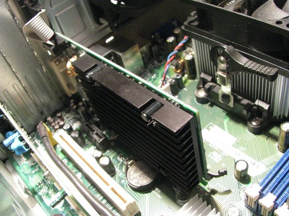

  3. Dell Inspiron 531 Graphics Card Replacement, Locating the Graphics Card: crwdns2935265:03crwdnd2935265:01crwdnd2935265:02crwdne2935265:0 Dell Inspiron 531 Graphics Card Replacement, Locating the Graphics Card: crwdns2935265:03crwdnd2935265:02crwdnd2935265:02crwdne2935265:0
    • The graphics card is attached to the back of the desktop.
    • The graphics card is located below the three fans.

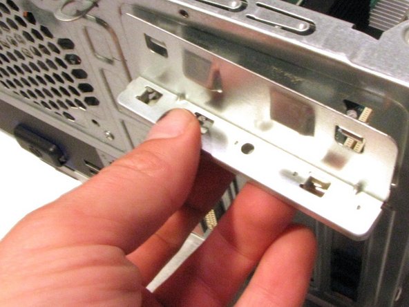

  5. Dell Inspiron 531 Graphics Card Replacement: crwdns2935265:05crwdnd2935265:01crwdnd2935265:02crwdne2935265:0 Dell Inspiron 531 Graphics Card Replacement: crwdns2935265:05crwdnd2935265:02crwdnd2935265:02crwdne2935265:0
    • Remove the support bracket by lifting up and out.
    • There are tabs that hold the bracket in place, therefor lifting up is an important detail.

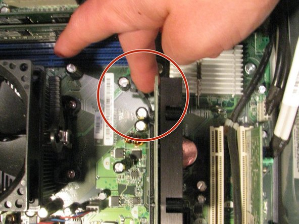

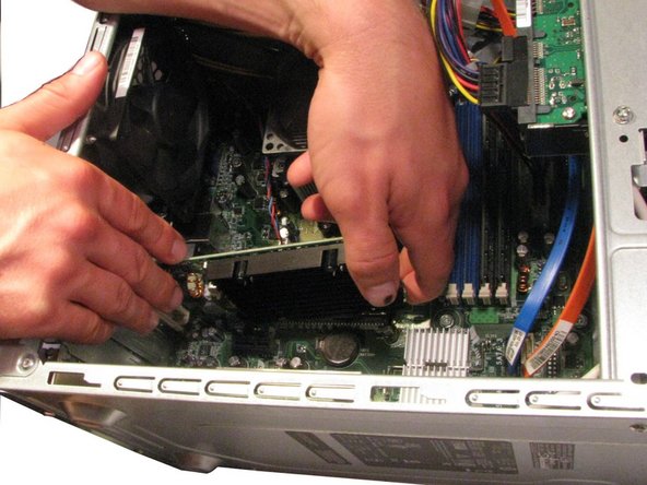

  6. Dell Inspiron 531 Graphics Card Replacement, Removing the Graphics Card: crwdns2935265:06crwdnd2935265:01crwdnd2935265:02crwdne2935265:0 Dell Inspiron 531 Graphics Card Replacement, Removing the Graphics Card: crwdns2935265:06crwdnd2935265:02crwdnd2935265:02crwdne2935265:0
    • Locate the push tab that locks the graphics card into place.
    • Push the tab away from the graphics card and towards the fan.
    • Hold the tab in this position through step 7.
  7. Dell Inspiron 531 Graphics Card Replacement: crwdns2935265:07crwdnd2935265:01crwdnd2935265:02crwdne2935265:0 Dell Inspiron 531 Graphics Card Replacement: crwdns2935265:07crwdnd2935265:02crwdnd2935265:02crwdne2935265:0
    • Keep the tab pushed away from the graphics card (see Step 6).
    • Gently lift the graphics card up and out of the desktop.
