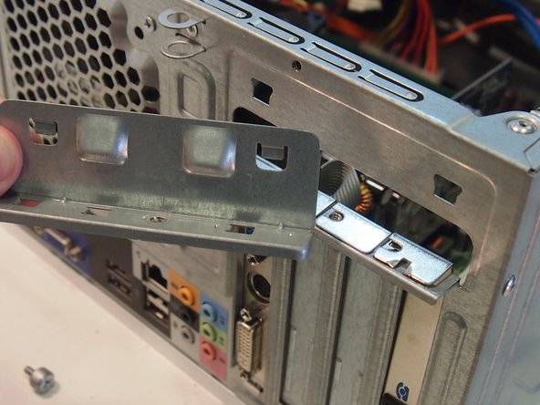

    • Remove the two screws.
    • Slide out the panel back.
  2. Dell Inspiron 530 DCMF Graphics Card Replacement: crwdns2935265:02crwdnd2935265:01crwdnd2935265:01crwdne2935265:0
    • Locate the graphics card. It can be identified by its position on the motherboard and built-in fan.
  3. Dell Inspiron 530 DCMF Graphics Card Replacement: crwdns2935265:03crwdnd2935265:01crwdnd2935265:02crwdne2935265:0 Dell Inspiron 530 DCMF Graphics Card Replacement: crwdns2935265:03crwdnd2935265:02crwdnd2935265:02crwdne2935265:0
    • Unscrew the screw.
    • Remove the metal piece that holds the graphics card in place.
  4. Dell Inspiron 530 DCMF Graphics Card Replacement: crwdns2935265:04crwdnd2935265:01crwdnd2935265:01crwdne2935265:0
    • The graphics card can now be taken out by sliding it upwards.
