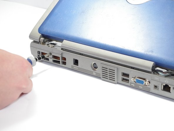

    • Remove battery
    • Open screen so that it lies flat.
  2. Dell Inspiron 5100 PP07L Heatsink Replacement: crwdns2935265:02crwdnd2935265:01crwdnd2935265:02crwdne2935265:0 Dell Inspiron 5100 PP07L Heatsink Replacement: crwdns2935265:02crwdnd2935265:02crwdnd2935265:02crwdne2935265:0
    • Starting from the right side of the hinge cover, use the flat end of the spudger to pry up the hinge cover and gently remove it.
  3. Dell Inspiron 5100 PP07L Heatsink Replacement: crwdns2935265:03crwdnd2935265:01crwdnd2935265:02crwdne2935265:0 Dell Inspiron 5100 PP07L Heatsink Replacement: crwdns2935265:03crwdnd2935265:02crwdnd2935265:02crwdne2935265:0
    • Using a Phillips screwdriver remove the four M2 x 3-mm screws holding in the keyboard.
  4. Dell Inspiron 5100 PP07L Heatsink Replacement: crwdns2935265:04crwdnd2935265:01crwdnd2935265:01crwdne2935265:0
    • Lift keyboard and detach the interface connector.
    • Take extra care when removing and handling the keyboard. The key caps on the keyboard are fragile and easily come off.

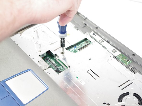

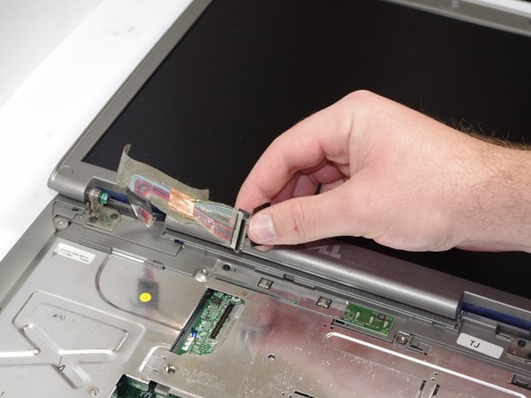

  5. Dell Inspiron 5100 PP07L Heatsink Replacement, Heatsink: crwdns2935265:05crwdnd2935265:01crwdnd2935265:02crwdne2935265:0 Dell Inspiron 5100 PP07L Heatsink Replacement, Heatsink: crwdns2935265:05crwdnd2935265:02crwdnd2935265:02crwdne2935265:0
    • Detach screen connector
  6. Dell Inspiron 5100 PP07L Heatsink Replacement: crwdns2935265:06crwdnd2935265:01crwdnd2935265:02crwdne2935265:0 Dell Inspiron 5100 PP07L Heatsink Replacement: crwdns2935265:06crwdnd2935265:02crwdnd2935265:02crwdne2935265:0
    • Remove two screws (5.8mm) located behind the screen.
  7. Dell Inspiron 5100 PP07L Heatsink Replacement: crwdns2935265:07crwdnd2935265:01crwdnd2935265:02crwdne2935265:0 Dell Inspiron 5100 PP07L Heatsink Replacement: crwdns2935265:07crwdnd2935265:02crwdnd2935265:02crwdne2935265:0
    • Remove one screw (8.6 mm) on metal plating.
    • Remove the metal plating

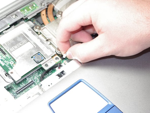

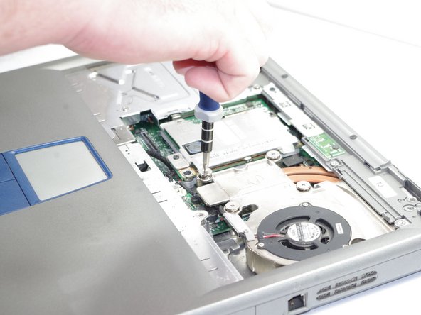

  8. Dell Inspiron 5100 PP07L Heatsink Replacement: crwdns2935265:08crwdnd2935265:01crwdnd2935265:02crwdne2935265:0 Dell Inspiron 5100 PP07L Heatsink Replacement: crwdns2935265:08crwdnd2935265:02crwdnd2935265:02crwdne2935265:0
    • Loosen four screws.
    • These screws are attached to the heat sink and cannot be completely removed.
  9. Dell Inspiron 5100 PP07L Heatsink Replacement: crwdns2935265:09crwdnd2935265:01crwdnd2935265:02crwdne2935265:0 Dell Inspiron 5100 PP07L Heatsink Replacement: crwdns2935265:09crwdnd2935265:02crwdnd2935265:02crwdne2935265:0
    • Disconnect the wire connecting the heatsink to the motherboard.
  10. Dell Inspiron 5100 PP07L Heatsink Replacement: crwdns2935265:010crwdnd2935265:01crwdnd2935265:01crwdne2935265:0
    • Slide the heatsink away from the screen and lift.
