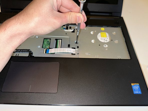

    • Use a flat screw driver to pry against the angled metal.
    • Remove the 3 small screws that were under the optical drive using a small tip Phillips screwdriver.

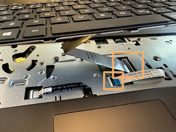

    • Use a small flat-head screwdriver to pry up at each point indicated to unclip the keyboard from the chassis.
    • Lift the keyboard 2-3 inches up and carefully disconnect the two ribbon cables by unlatching the mechanism and carefully sliding the cable out horizontally.
    • Place the keyboard to the side.

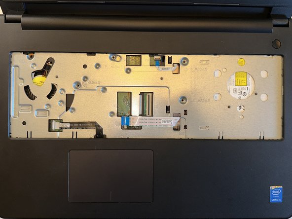

    • Remove the 5 screws using the small Phillips screwdriver.

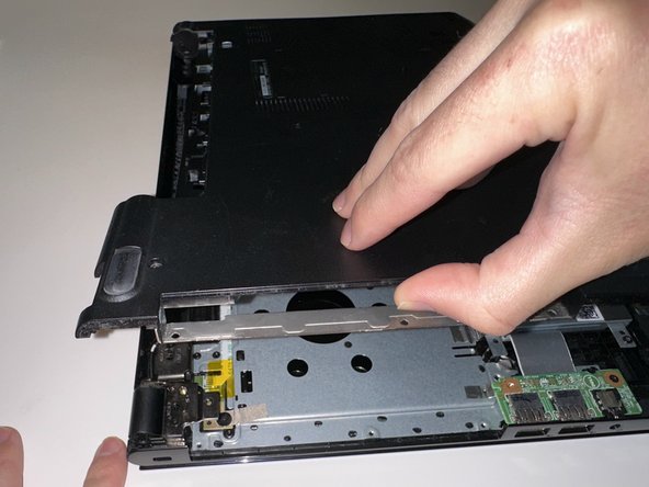

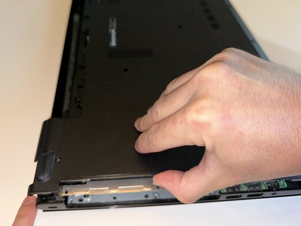

  5. Dell Inspiron 5100 (2015) Thermal Paste Replacement: crwdns2935265:05crwdnd2935265:01crwdnd2935265:03crwdne2935265:0 Dell Inspiron 5100 (2015) Thermal Paste Replacement: crwdns2935265:05crwdnd2935265:02crwdnd2935265:03crwdne2935265:0 Dell Inspiron 5100 (2015) Thermal Paste Replacement: crwdns2935265:05crwdnd2935265:03crwdnd2935265:03crwdne2935265:0
    • Grab the bottom panel where the optical drive was and lift straight up.
    • It should start popping clips and then come off without much force required.
    • Pay special attention to not break any plastic clips.

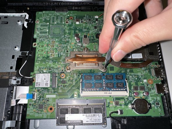

  6. Dell Inspiron 5100 (2015) Thermal Paste Replacement: crwdns2935265:06crwdnd2935265:01crwdnd2935265:03crwdne2935265:0 Dell Inspiron 5100 (2015) Thermal Paste Replacement: crwdns2935265:06crwdnd2935265:02crwdnd2935265:03crwdne2935265:0 Dell Inspiron 5100 (2015) Thermal Paste Replacement: crwdns2935265:06crwdnd2935265:03crwdnd2935265:03crwdne2935265:0

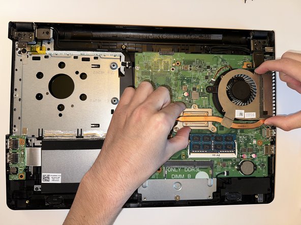

    • Loosen the screws one at a time and repeat until they are fully unscrewed.
    • Unplug the fan cable from the header by sliding it out horizontally.

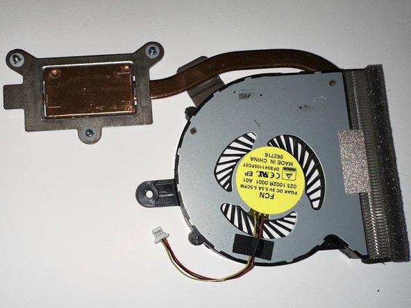

    • Lift the cooler off the CPU with one hand on the CPU area and one hand on the fan assembly.

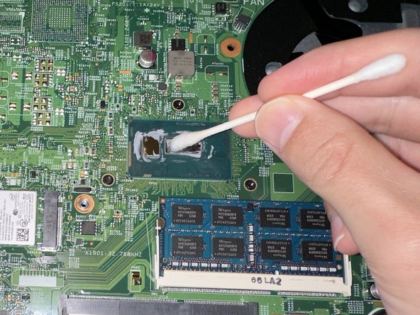

  7. Dell Inspiron 5100 (2015) Thermal Paste Replacement: crwdns2935265:07crwdnd2935265:01crwdnd2935265:03crwdne2935265:0 Dell Inspiron 5100 (2015) Thermal Paste Replacement: crwdns2935265:07crwdnd2935265:02crwdnd2935265:03crwdne2935265:0 Dell Inspiron 5100 (2015) Thermal Paste Replacement: crwdns2935265:07crwdnd2935265:03crwdnd2935265:03crwdne2935265:0
    • Using paper towels, q-tips, and isopropyl alcohol, clean off the old thermal paste on the CPU and heatsink.
    • Be careful around the CPU; it is delicate and can be damaged.

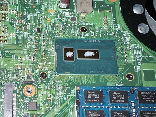

  8. Dell Inspiron 5100 (2015) Thermal Paste Replacement: crwdns2935265:08crwdnd2935265:01crwdnd2935265:02crwdne2935265:0 Dell Inspiron 5100 (2015) Thermal Paste Replacement: crwdns2935265:08crwdnd2935265:02crwdnd2935265:02crwdne2935265:0
    • Apply a grain of rice amount of thermal paste to the CPU in the indicated spots.
