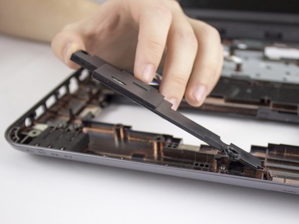

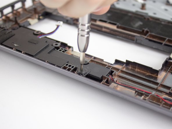

  14. Dell Inspiron 17R-5737 Speaker Replacement, Speaker: crwdns2935265:014crwdnd2935265:01crwdnd2935265:03crwdne2935265:0 Dell Inspiron 17R-5737 Speaker Replacement, Speaker: crwdns2935265:014crwdnd2935265:02crwdnd2935265:03crwdne2935265:0 Dell Inspiron 17R-5737 Speaker Replacement, Speaker: crwdns2935265:014crwdnd2935265:03crwdnd2935265:03crwdne2935265:0
    • These screws strip easily.
    • Remove two 1.6mm screws on each speaker with a JIS #00 screwdriver.
    • Remove the speakers.
