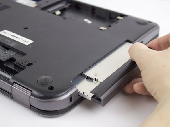

  4. Dell Inspiron 17R-5737 Screen Replacement, Optical Drive: crwdns2935265:04crwdnd2935265:01crwdnd2935265:02crwdne2935265:0 Dell Inspiron 17R-5737 Screen Replacement, Optical Drive: crwdns2935265:04crwdnd2935265:02crwdnd2935265:02crwdne2935265:0
    • Remove one 4.8mm screw with a JIS #00 screwdriver.
    • Remove the optical drive.

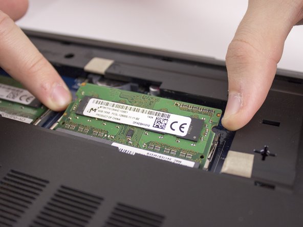

  7. Dell Inspiron 17R-5737 Screen Replacement, RAM: crwdns2935265:07crwdnd2935265:01crwdnd2935265:02crwdne2935265:0 Dell Inspiron 17R-5737 Screen Replacement, RAM: crwdns2935265:07crwdnd2935265:02crwdnd2935265:02crwdne2935265:0
    • Slide the two clips away from the RAM.
    • Lift the RAM out.

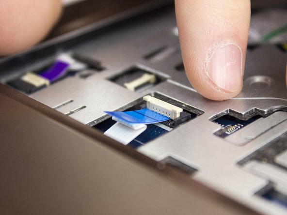

    • Slowly lift the keyboard.

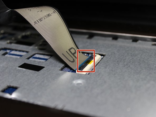

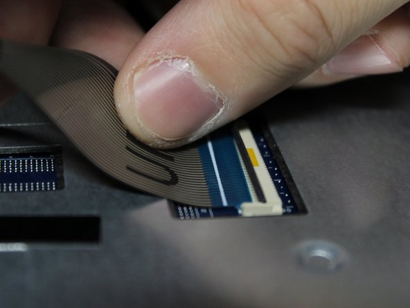

    • Lift the locking flap that holds the ribbon cable in place.
    • The white line on this ribbon cable marks the edge of the connection area. To reinstall, insert the cable into the connector up to this line, and then close the locking flap.
    • Remove the keyboard.

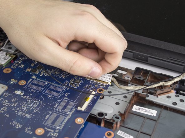

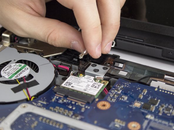

  12. Dell Inspiron 17R-5737 Screen Replacement, Screen: crwdns2935265:012crwdnd2935265:01crwdnd2935265:03crwdne2935265:0 Dell Inspiron 17R-5737 Screen Replacement, Screen: crwdns2935265:012crwdnd2935265:02crwdnd2935265:03crwdne2935265:0 Dell Inspiron 17R-5737 Screen Replacement, Screen: crwdns2935265:012crwdnd2935265:03crwdnd2935265:03crwdne2935265:0
    • Remove the display cable on the top-right of the motherboard.
    • Ensure the cable snakes through the path in the case when putting it back together.
    • Remove the two antennae from Wi-Fi chip.

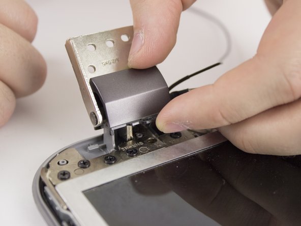

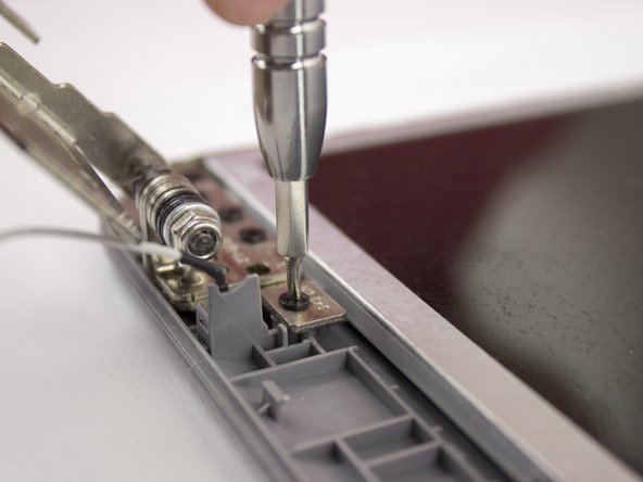

  15. Dell Inspiron 17R-5737 Screen Replacement: crwdns2935265:015crwdnd2935265:01crwdnd2935265:02crwdne2935265:0 Dell Inspiron 17R-5737 Screen Replacement: crwdns2935265:015crwdnd2935265:02crwdnd2935265:02crwdne2935265:0
    • Remove the one 4.8mm screw from each hinge cover with a JIS #00 screwdriver.
    • Do not over-tighten these screws during reassembly, as the hinge cover is thin and may break.
    • Remove the hinge cover.

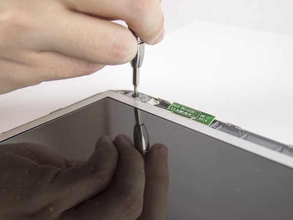

  16. Dell Inspiron 17R-5737 Screen Replacement: crwdns2935265:016crwdnd2935265:01crwdnd2935265:03crwdne2935265:0 Dell Inspiron 17R-5737 Screen Replacement: crwdns2935265:016crwdnd2935265:02crwdnd2935265:03crwdne2935265:0 Dell Inspiron 17R-5737 Screen Replacement: crwdns2935265:016crwdnd2935265:03crwdnd2935265:03crwdne2935265:0
    • Remove the five 4.8mm screws from each hinge with a JIS #00 screwdriver.
    • Remove one 4.8mm screw from the top left and the top right of the screen with a JIS #00 screwdriver.

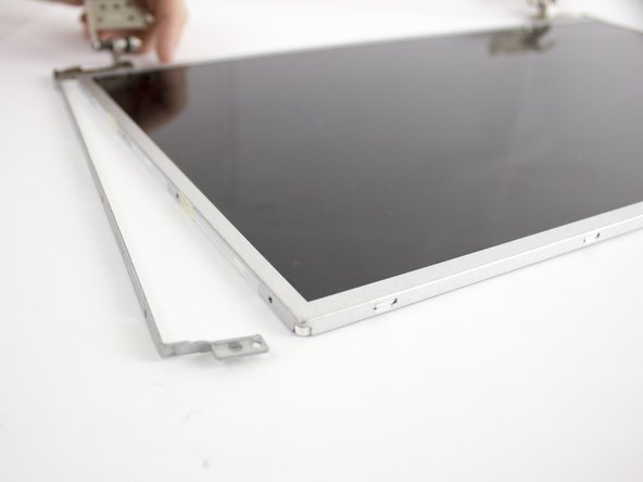

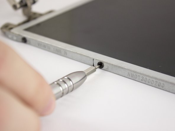

  18. Dell Inspiron 17R-5737 Screen Replacement: crwdns2935265:018crwdnd2935265:01crwdnd2935265:03crwdne2935265:0 Dell Inspiron 17R-5737 Screen Replacement: crwdns2935265:018crwdnd2935265:02crwdnd2935265:03crwdne2935265:0 Dell Inspiron 17R-5737 Screen Replacement: crwdns2935265:018crwdnd2935265:03crwdnd2935265:03crwdne2935265:0
    • Remove the four 3.2mm screws from each rail with a JIS #00 screwdriver.
    • Remove the rails from the screen.
