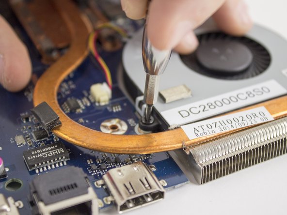

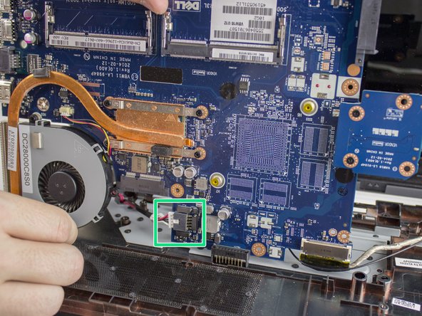

  14. Dell Inspiron 17R-5737 Cooling Fans Replacement, Cooling Fan: crwdns2935265:014crwdnd2935265:01crwdnd2935265:02crwdne2935265:0 Dell Inspiron 17R-5737 Cooling Fans Replacement, Cooling Fan: crwdns2935265:014crwdnd2935265:02crwdnd2935265:02crwdne2935265:0
    • Remove one 3.2mm screw that connects the fan to the motherboard with a J00 Phillips head screwdriver.
    • Disconnect the cable that connects the fan to the motherboard.
    • Remove the cooling fan.
