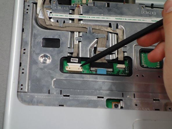

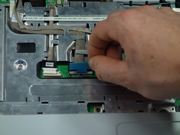

  6. Dell Inspiron 1750 Screen Replacement: crwdns2935265:06crwdnd2935265:01crwdnd2935265:03crwdne2935265:0 Dell Inspiron 1750 Screen Replacement: crwdns2935265:06crwdnd2935265:02crwdnd2935265:03crwdne2935265:0 Dell Inspiron 1750 Screen Replacement: crwdns2935265:06crwdnd2935265:03crwdnd2935265:03crwdne2935265:0

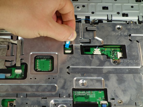

    • Always pull wires from their plastic ends, not their cables, to avoid wire damage.
    • Locate the three wires in the top left corner of the metal panel.
    • Use the spudger to push the two cables out of their ports.
    • Pull the blue tab directly up to remove middle wire.
  7. Dell Inspiron 1750 Screen Replacement: crwdns2935265:07crwdnd2935265:01crwdnd2935265:02crwdne2935265:0 Dell Inspiron 1750 Screen Replacement: crwdns2935265:07crwdnd2935265:02crwdnd2935265:02crwdne2935265:0
    • Remove the three 1mm Phillips #00 screws on the metal plate.
    • Lift the black cover and slide the blue tab away from the cover.
  8. Dell Inspiron 1750 Screen Replacement: crwdns2935265:08crwdnd2935265:01crwdnd2935265:03crwdne2935265:0 Dell Inspiron 1750 Screen Replacement: crwdns2935265:08crwdnd2935265:02crwdnd2935265:03crwdne2935265:0 Dell Inspiron 1750 Screen Replacement: crwdns2935265:08crwdnd2935265:03crwdnd2935265:03crwdne2935265:0

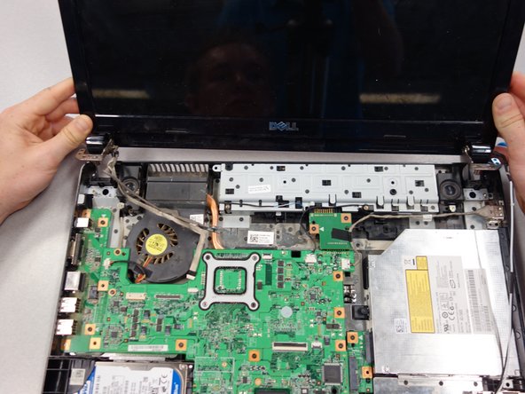

  9. Dell Inspiron 1750 Screen Replacement, Screen: crwdns2935265:09crwdnd2935265:01crwdnd2935265:03crwdne2935265:0 Dell Inspiron 1750 Screen Replacement, Screen: crwdns2935265:09crwdnd2935265:02crwdnd2935265:03crwdne2935265:0 Dell Inspiron 1750 Screen Replacement, Screen: crwdns2935265:09crwdnd2935265:03crwdnd2935265:03crwdne2935265:0
    • Use the spudger to lift the wires from their connections.
    • Remember to pull wires from their plastic ends, not their cables, to avoid wire damage.
    • Flip the laptop over and pull the connections through until they are free from the laptop interior.
  10. Dell Inspiron 1750 Screen Replacement: crwdns2935265:010crwdnd2935265:01crwdnd2935265:02crwdne2935265:0 Dell Inspiron 1750 Screen Replacement: crwdns2935265:010crwdnd2935265:02crwdnd2935265:02crwdne2935265:0
    • Remove the two 2mm Phillips #0 screws from the screen hinges.
    • Lift the screen away from the laptop and gently set it down.

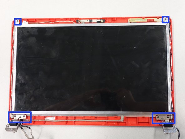

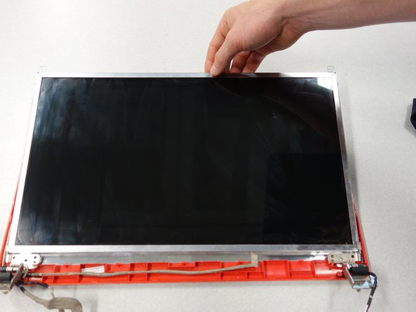

  11. Dell Inspiron 1750 Screen Replacement: crwdns2935265:011crwdnd2935265:01crwdnd2935265:03crwdne2935265:0 Dell Inspiron 1750 Screen Replacement: crwdns2935265:011crwdnd2935265:02crwdnd2935265:03crwdne2935265:0 Dell Inspiron 1750 Screen Replacement: crwdns2935265:011crwdnd2935265:03crwdnd2935265:03crwdne2935265:0
    • Use the plastic opening tool to remove the plastic cover from the screen.
    • Remove the eight 2mm Phillips #0 screws from the corners of the screen.
    • Lift the screen away from the back panel.

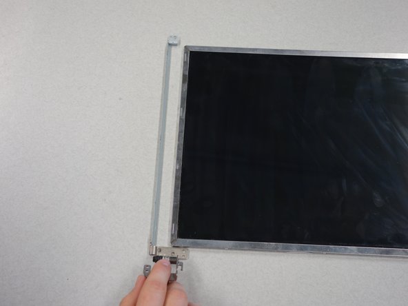

  12. Dell Inspiron 1750 Screen Replacement: crwdns2935265:012crwdnd2935265:01crwdnd2935265:02crwdne2935265:0 Dell Inspiron 1750 Screen Replacement: crwdns2935265:012crwdnd2935265:02crwdnd2935265:02crwdne2935265:0
    • Remove the four 2mm Phillips #0 screws from the sides of the screen.
    • Remove the side railings from both sides of the screen by pulling the railings gently away from the screen.
