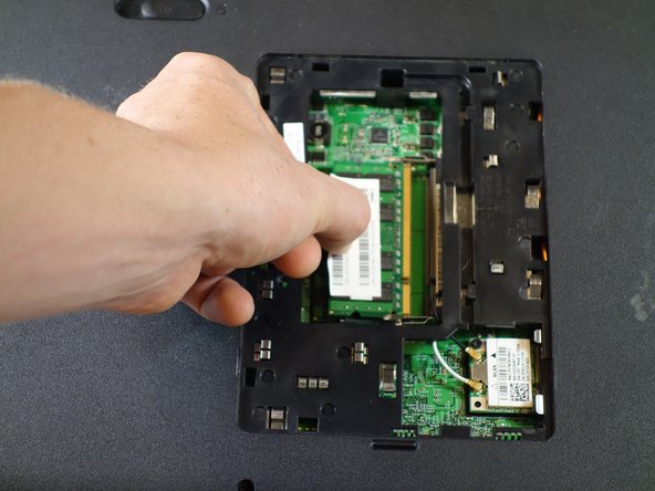

    1. Dell Inspiron 1750 RAM Replacement, RAM: crwdns2935265:03crwdnd2935265:01crwdnd2935265:03crwdne2935265:0 Dell Inspiron 1750 RAM Replacement, RAM: crwdns2935265:03crwdnd2935265:02crwdnd2935265:03crwdne2935265:0 Dell Inspiron 1750 RAM Replacement, RAM: crwdns2935265:03crwdnd2935265:03crwdnd2935265:03crwdne2935265:0
      • Remove the one 2mm Phillips #00 screw on the module cover.
      • Use the plastic opening tool to lift the module cover.
    2. Dell Inspiron 1750 RAM Replacement: crwdns2935265:04crwdnd2935265:01crwdnd2935265:02crwdne2935265:0 Dell Inspiron 1750 RAM Replacement: crwdns2935265:04crwdnd2935265:02crwdnd2935265:02crwdne2935265:0
      • Pull the metal tabs away from the RAM chip to release it from the motherboard.
      • Pull the chip up from the laptop.
      • Use the plastic opening tool to lift the chip out if it's difficult to do with your hands.
      • Repeat this process for the RAM chip directly beneath the last one.
