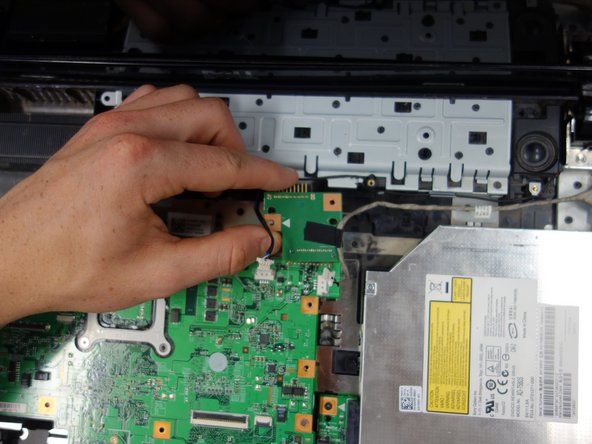

  6. Dell Inspiron 1750 Internal Fan Replacement: crwdns2935265:06crwdnd2935265:01crwdnd2935265:03crwdne2935265:0 Dell Inspiron 1750 Internal Fan Replacement: crwdns2935265:06crwdnd2935265:02crwdnd2935265:03crwdne2935265:0 Dell Inspiron 1750 Internal Fan Replacement: crwdns2935265:06crwdnd2935265:03crwdnd2935265:03crwdne2935265:0
    • Always pull wires from their plastic ends, not their cables, to avoid wire damage.
    • Locate the three wires in the top left corner of the metal panel.
    • Use the spudger to push the two cables out of their ports.
    • Pull the blue tab directly up to remove middle wire.

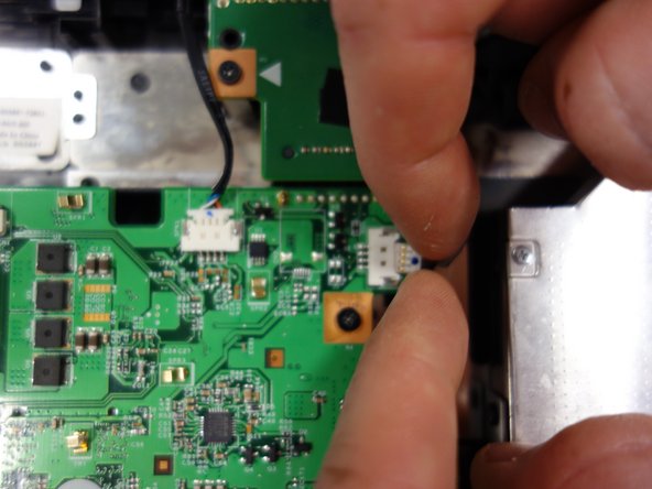

  10. Dell Inspiron 1750 Internal Fan Replacement: crwdns2935265:010crwdnd2935265:01crwdnd2935265:03crwdne2935265:0 Dell Inspiron 1750 Internal Fan Replacement: crwdns2935265:010crwdnd2935265:02crwdnd2935265:03crwdne2935265:0 Dell Inspiron 1750 Internal Fan Replacement: crwdns2935265:010crwdnd2935265:03crwdnd2935265:03crwdne2935265:0
    • Pull the three connections away from their ports using both fingers.
    • Remove the battery connection chip from the motherboard.

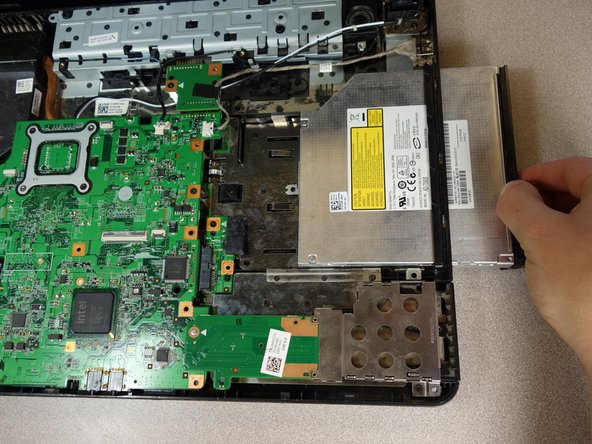

  11. Dell Inspiron 1750 Internal Fan Replacement: crwdns2935265:011crwdnd2935265:01crwdnd2935265:02crwdne2935265:0 Dell Inspiron 1750 Internal Fan Replacement: crwdns2935265:011crwdnd2935265:02crwdnd2935265:02crwdne2935265:0
    • Slide the hard drive out away from the laptop until it is free from the motherboard
    • Repeat this process for the disk drive.
    • You may leave these components in their trays.

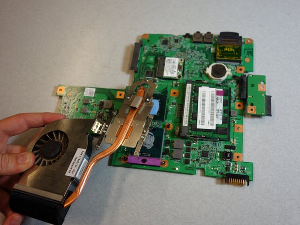

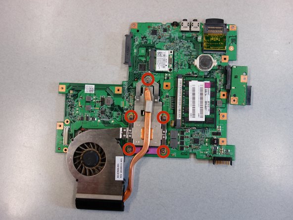

  13. Dell Inspiron 1750 Internal Fan Replacement: crwdns2935265:013crwdnd2935265:01crwdnd2935265:03crwdne2935265:0 Dell Inspiron 1750 Internal Fan Replacement: crwdns2935265:013crwdnd2935265:02crwdnd2935265:03crwdne2935265:0 Dell Inspiron 1750 Internal Fan Replacement: crwdns2935265:013crwdnd2935265:03crwdnd2935265:03crwdne2935265:0
    • Lift the motherboard by its top end and remove it from the laptop.
    • Flip the motherboard over to reveal the fan.
    • The screws in the next step are captive screws and will not come completely free, so do not try to remove from the fan.
    • Remove the five 1mm Phillips #00 captive screws from the internal fan.
    • Lift the fan away from the motherboard.
    • Refer to iFixit's guide for removal and cleaning of the thermal paste. How to Apply Thermal Paste

the board for the battery shows a screw on the left hand side after you remove the plate, however when you go to replace if you put this screw in 1st then the plate will not lay flat, so be careful u might be unplugging all those little wires Again!
