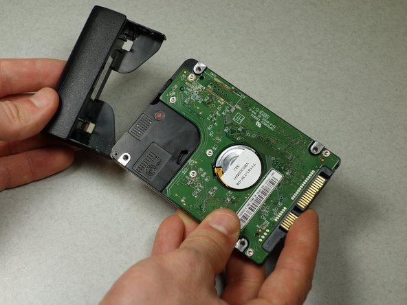

    1. Dell Inspiron 1750 Hard Drive Replacement, Hard Drive: crwdns2935265:03crwdnd2935265:01crwdnd2935265:02crwdne2935265:0 Dell Inspiron 1750 Hard Drive Replacement, Hard Drive: crwdns2935265:03crwdnd2935265:02crwdnd2935265:02crwdne2935265:0
      • Remove the two 1mm double wide Phillips #00 screws.
      • Pull the hard drive away from the laptop.
    2. Dell Inspiron 1750 Hard Drive Replacement: crwdns2935265:04crwdnd2935265:01crwdnd2935265:02crwdne2935265:0 Dell Inspiron 1750 Hard Drive Replacement: crwdns2935265:04crwdnd2935265:02crwdnd2935265:02crwdne2935265:0
      • Keep all screws in a safe place. You may need to use them for your new hard drive.
      • Remove the two #00 1mm screws on both sides of the hard drive.
      • Pull the hard drive cover away from the hard drive and set the cover aside.
