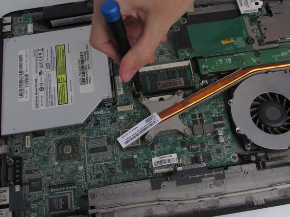

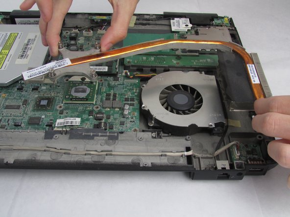

  6. Dell Inspiron 1721 CPU Fan Replacement, Heat Sink: crwdns2935265:06crwdnd2935265:01crwdnd2935265:03crwdne2935265:0 Dell Inspiron 1721 CPU Fan Replacement, Heat Sink: crwdns2935265:06crwdnd2935265:02crwdnd2935265:03crwdne2935265:0 Dell Inspiron 1721 CPU Fan Replacement, Heat Sink: crwdns2935265:06crwdnd2935265:03crwdnd2935265:03crwdne2935265:0
    • Unscrew the Phillips #0 screws attaching the heat sink to the motherboard.
    • The screws attaching the heat sink to the motherboard are part of the heat sink.
    • Carefully remove the heat sink from the motherboard.
    • You may have to apply upward force while removing the heat sink from the motherboard, due to the thermal paste between it and the CPU.

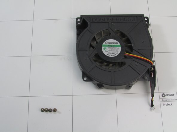

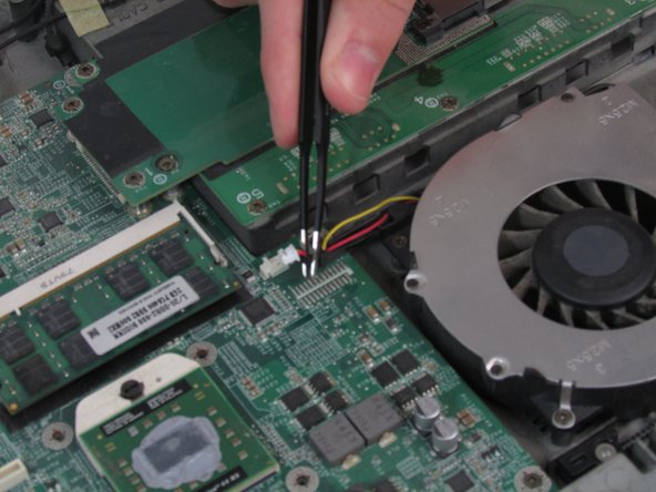

  7. Dell Inspiron 1721 CPU Fan Replacement, CPU Fan: crwdns2935265:07crwdnd2935265:01crwdnd2935265:02crwdne2935265:0 Dell Inspiron 1721 CPU Fan Replacement, CPU Fan: crwdns2935265:07crwdnd2935265:02crwdnd2935265:02crwdne2935265:0
    • Disconnect the fan power cable from the motherboard using a pair of tweezers.

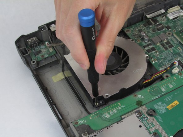

  8. Dell Inspiron 1721 CPU Fan Replacement: crwdns2935265:08crwdnd2935265:01crwdnd2935265:03crwdne2935265:0 Dell Inspiron 1721 CPU Fan Replacement: crwdns2935265:08crwdnd2935265:02crwdnd2935265:03crwdne2935265:0 Dell Inspiron 1721 CPU Fan Replacement: crwdns2935265:08crwdnd2935265:03crwdnd2935265:03crwdne2935265:0
    • Remove four 3mm Phillips #1 screws.
    • Gently remove the fan from the motherboard.
