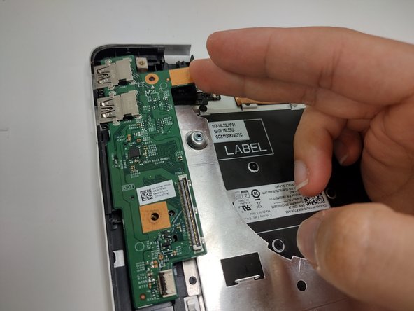

  28. Dell Inspiron 17" 7786 2-in-1 Keyboard Replacement, I/O Board (SD and x2 USB ports): crwdns2935265:028crwdnd2935265:01crwdnd2935265:02crwdne2935265:0 Dell Inspiron 17" 7786 2-in-1 Keyboard Replacement, I/O Board (SD and x2 USB ports): crwdns2935265:028crwdnd2935265:02crwdnd2935265:02crwdne2935265:0
    • Lift the latch holding down the ribbon cable on the I/O board, then pull it away using the blue tab.
    • Lift the I/O board upwards to remove it from the assembly.

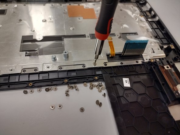

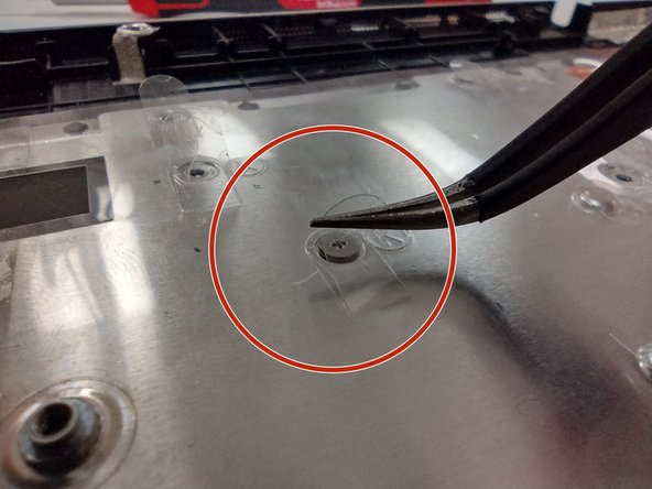

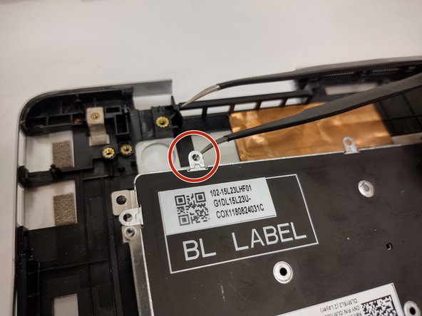

  35. Dell Inspiron 17" 7786 2-in-1 Keyboard Replacement, Keyboard: crwdns2935265:035crwdnd2935265:01crwdnd2935265:03crwdne2935265:0 Dell Inspiron 17" 7786 2-in-1 Keyboard Replacement, Keyboard: crwdns2935265:035crwdnd2935265:02crwdnd2935265:03crwdne2935265:0 Dell Inspiron 17" 7786 2-in-1 Keyboard Replacement, Keyboard: crwdns2935265:035crwdnd2935265:03crwdnd2935265:03crwdne2935265:0
    • Remove all 32 screws securing the metal plate to the assembly using a Phillips #0 screwdriver.
    • Dell's official manual mentions removing the tape holding the metal plate down. This is optional since you can pick and lift the outlines of small tabs covering the screws of the right hand area of the assembly.
  36. Dell Inspiron 17" 7786 2-in-1 Keyboard Replacement: crwdns2935265:036crwdnd2935265:01crwdnd2935265:02crwdne2935265:0 Dell Inspiron 17" 7786 2-in-1 Keyboard Replacement: crwdns2935265:036crwdnd2935265:02crwdnd2935265:02crwdne2935265:0
    • The metal plate can be easily bent. Ensure you do not grip too hard, or allow it to be bent.
    • Lift the metal plate upwards by the edge, or use the metal indents used for the screws.
