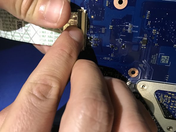

    • Proceed to lift the latch which secures the ZIF display cable to the motherboard.
    • Disconnect the display cable from the motherboard.

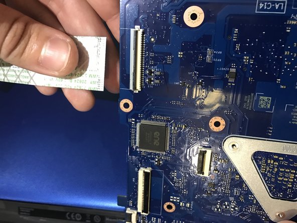

    • Turn the motherboard over.
    • Lift the latch to disconnect the I/O-board cable from the motherboard.

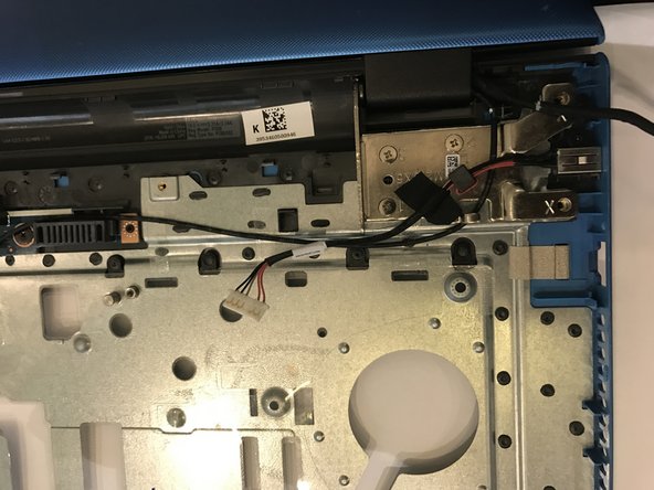

    • Using a Phillips 0 screwdriver, remove the screw (M2 x 3) the power-adapter port to the palm-rest assembly.
    • Peel off the tape that secures the power-adapter port to the palm-rest assembly.
  33. Dell Inspiron 17-5755 Display Panel Replacement: crwdns2935265:033crwdnd2935265:01crwdnd2935265:03crwdne2935265:0 Dell Inspiron 17-5755 Display Panel Replacement: crwdns2935265:033crwdnd2935265:02crwdnd2935265:03crwdne2935265:0 Dell Inspiron 17-5755 Display Panel Replacement: crwdns2935265:033crwdnd2935265:03crwdnd2935265:03crwdne2935265:0
    • Carefully detach the antenna cables from their respective routing guides

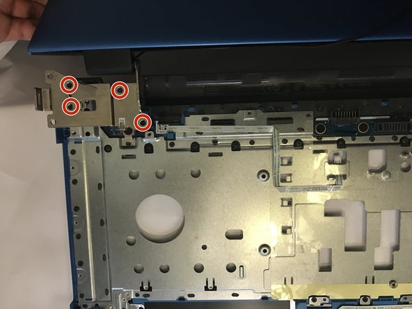

  34. Dell Inspiron 17-5755 Display Panel Replacement: crwdns2935265:034crwdnd2935265:01crwdnd2935265:02crwdne2935265:0 Dell Inspiron 17-5755 Display Panel Replacement: crwdns2935265:034crwdnd2935265:02crwdnd2935265:02crwdne2935265:0
    • Using a Phillips 0 screwdriver, remove the 7 screws (M2.5 x 5) that secure the display hinges to the palm-rest assembly.
    • Detach the display assembly from the palm rest assembly
