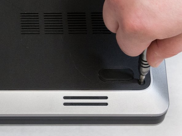

  4. Dell Inspiron 17-5748 Speakers Replacement, Speakers: crwdns2935265:04crwdnd2935265:01crwdnd2935265:03crwdne2935265:0 Dell Inspiron 17-5748 Speakers Replacement, Speakers: crwdns2935265:04crwdnd2935265:02crwdnd2935265:03crwdne2935265:0 Dell Inspiron 17-5748 Speakers Replacement, Speakers: crwdns2935265:04crwdnd2935265:03crwdnd2935265:03crwdne2935265:0
    • Remove the 4.5 mm Phillips #0 screw holding the Optical Drive in place.
    • Slide the Optical Drive out of the device.

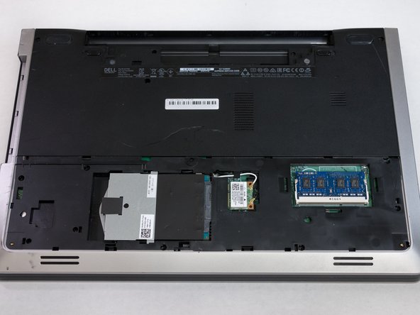

  5. Dell Inspiron 17-5748 Speakers Replacement: crwdns2935265:05crwdnd2935265:01crwdnd2935265:02crwdne2935265:0 Dell Inspiron 17-5748 Speakers Replacement: crwdns2935265:05crwdnd2935265:02crwdnd2935265:02crwdne2935265:0
    • Remove the two 4.5 mm Phillips #0 screws on the access panel door.
  6. Dell Inspiron 17-5748 Speakers Replacement: crwdns2935265:06crwdnd2935265:01crwdnd2935265:02crwdne2935265:0 Dell Inspiron 17-5748 Speakers Replacement: crwdns2935265:06crwdnd2935265:02crwdnd2935265:02crwdne2935265:0
    • Using a plastic opening tool, pry open the access panel, exposing the disk drive, RAM, and wireless module.
  7. Dell Inspiron 17-5748 Speakers Replacement: crwdns2935265:07crwdnd2935265:01crwdnd2935265:03crwdne2935265:0 Dell Inspiron 17-5748 Speakers Replacement: crwdns2935265:07crwdnd2935265:02crwdnd2935265:03crwdne2935265:0 Dell Inspiron 17-5748 Speakers Replacement: crwdns2935265:07crwdnd2935265:03crwdnd2935265:03crwdne2935265:0
    • Remove the 2.5 mm Phillips #0 screw securing the hard drive.
    • Slide the hard drive out using the pull tab.
    • Remove the hard drive from the device.

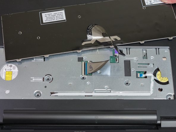

    • Open the laptop and locate the keyboard.
  9. Dell Inspiron 17-5748 Speakers Replacement: crwdns2935265:09crwdnd2935265:01crwdnd2935265:02crwdne2935265:0 Dell Inspiron 17-5748 Speakers Replacement: crwdns2935265:09crwdnd2935265:02crwdnd2935265:02crwdne2935265:0

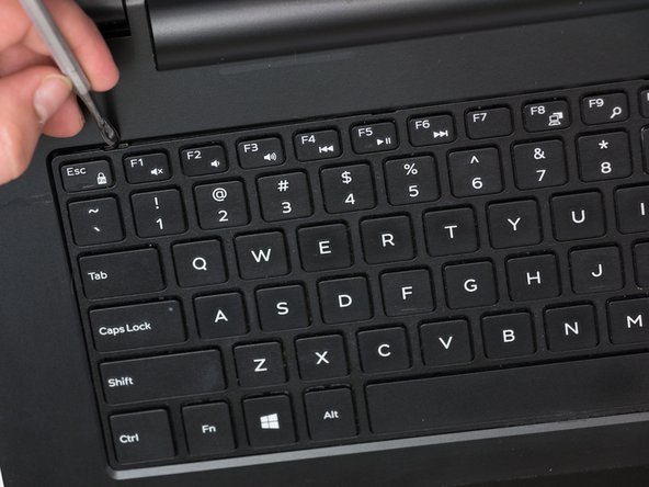

    • Locate the 5 keyboard tabs at the side of the keyboard closest to the screen.
    • Using a metal spudger, gently pry the keyboard tabs inwards until they loosened. You should hear a click.
  10. Dell Inspiron 17-5748 Speakers Replacement: crwdns2935265:010crwdnd2935265:01crwdnd2935265:02crwdne2935265:0 Dell Inspiron 17-5748 Speakers Replacement: crwdns2935265:010crwdnd2935265:02crwdnd2935265:02crwdne2935265:0
    • Do not remove the keyboard completely. The ribbon cable underneath, attaching it to the motherboard, must still be detached.
    • Lift the keyboard partially and flip it over.

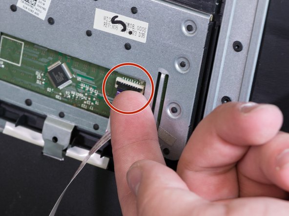

  11. Dell Inspiron 17-5748 Speakers Replacement: crwdns2935265:011crwdnd2935265:01crwdnd2935265:02crwdne2935265:0 Dell Inspiron 17-5748 Speakers Replacement: crwdns2935265:011crwdnd2935265:02crwdnd2935265:02crwdne2935265:0
    • Detach the ribbon cable from the motherboard by tilting up the black clip, releasing the cable.
    • Gently detach the cable and the keyboard from the laptop.

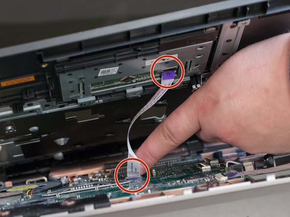

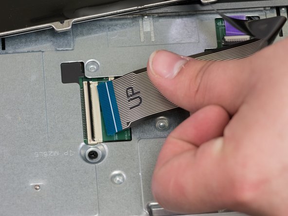

  13. Dell Inspiron 17-5748 Speakers Replacement: crwdns2935265:013crwdnd2935265:01crwdnd2935265:03crwdne2935265:0 Dell Inspiron 17-5748 Speakers Replacement: crwdns2935265:013crwdnd2935265:02crwdnd2935265:03crwdne2935265:0 Dell Inspiron 17-5748 Speakers Replacement: crwdns2935265:013crwdnd2935265:03crwdnd2935265:03crwdne2935265:0
    • Do not fully remove the palm rest until the ribbon cable underneath is detached.
    • Using a plastic opening tool, separate the plastic palm rest and partially lift the palm rest from the device.
    • Remove both ends of the ribbon cable. This can be done by flipping up the black tabs securing both ends.
    • Remove the palm rest from the device.

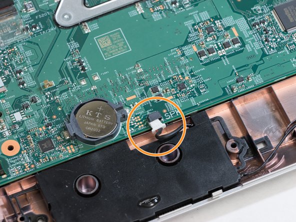

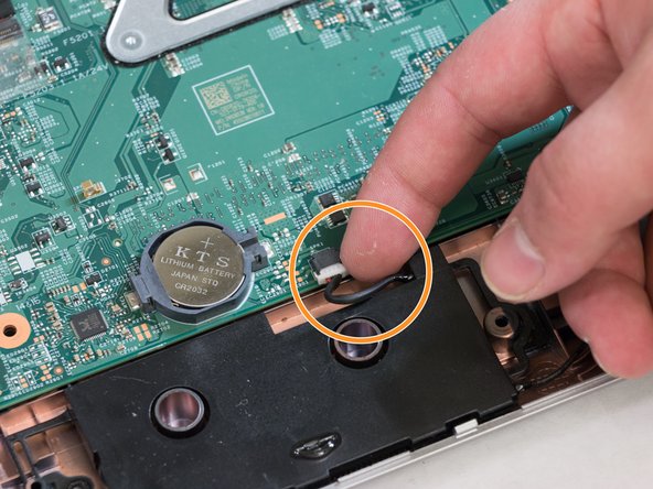

    • Locate the first speaker.
    • Unplug the speaker cable.

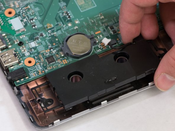

  15. Dell Inspiron 17-5748 Speakers Replacement: crwdns2935265:015crwdnd2935265:01crwdnd2935265:02crwdne2935265:0 Dell Inspiron 17-5748 Speakers Replacement: crwdns2935265:015crwdnd2935265:02crwdnd2935265:02crwdne2935265:0
    • Lift the speaker from the corner.
    • Remove the speaker.

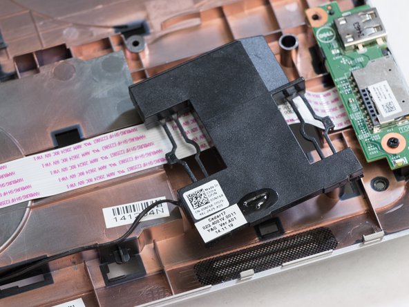

  16. Dell Inspiron 17-5748 Speakers Replacement: crwdns2935265:016crwdnd2935265:01crwdnd2935265:02crwdne2935265:0 Dell Inspiron 17-5748 Speakers Replacement: crwdns2935265:016crwdnd2935265:02crwdnd2935265:02crwdne2935265:0
    • Using the plastic opening tool, gently remove the second speaker.
