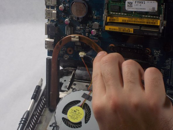

  11. Dell Inspiron 17-3721 Fan Replacement: crwdns2935265:011crwdnd2935265:01crwdnd2935265:01crwdne2935265:0
    • Located on the lower left, remove the 4mm PH1 Philips screw to the top of the fan.
  12. Dell Inspiron 17-3721 Fan Replacement: crwdns2935265:012crwdnd2935265:01crwdnd2935265:02crwdne2935265:0 Dell Inspiron 17-3721 Fan Replacement: crwdns2935265:012crwdnd2935265:02crwdnd2935265:02crwdne2935265:0
    • Remove the wire for the fan by pulling or pushing the white tab from the white box.
