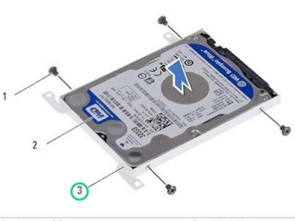

  2. Dell Inspiron 15z 5523 Hard Drive Assembly Replacement, Remove the Screws: crwdns2935265:02crwdnd2935265:01crwdnd2935265:01crwdne2935265:0
    • Remove the screws that secure the hard drive to the hard-drive bracket.
  3. Dell Inspiron 15z 5523 Hard Drive Assembly Replacement, Lifting the Hard Drive: crwdns2935265:03crwdnd2935265:01crwdnd2935265:02crwdne2935265:0 Dell Inspiron 15z 5523 Hard Drive Assembly Replacement, Lifting the Hard Drive: crwdns2935265:03crwdnd2935265:02crwdnd2935265:02crwdne2935265:0
    • Lift the hard drive out of the hard-drive bracket.
  4. Dell Inspiron 15z 5523 Hard Drive Assembly Replacement, Placing the Hard Drive: crwdns2935265:04crwdnd2935265:01crwdnd2935265:01crwdne2935265:0
    • Place the NEW hard drive into the hard-drive bracket.
  5. Dell Inspiron 15z 5523 Hard Drive Assembly Replacement, Align the Screw Holes: crwdns2935265:05crwdnd2935265:01crwdnd2935265:01crwdne2935265:0
    • Align the screw holes on the hard-drive bracket with the screw holes on the hard drive.
  6. Dell Inspiron 15z 5523 Hard Drive Assembly Replacement, Replace the Screws: crwdns2935265:06crwdnd2935265:01crwdnd2935265:01crwdne2935265:0
    • Replace the screws that secure the hard drive to the hard-drive bracket.
