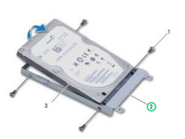

  3. Dell Inspiron 15z 1570 Hard Drive Replacement, Remove the Screws: crwdns2935265:03crwdnd2935265:01crwdnd2935265:01crwdne2935265:0
    • Remove the four screws that secure the hard drive to the hard drive bracket.
  4. Dell Inspiron 15z 1570 Hard Drive Replacement, Remove the Drive: crwdns2935265:04crwdnd2935265:01crwdnd2935265:01crwdne2935265:0
    • Remove the hard drive.
  5. Dell Inspiron 15z 1570 Hard Drive Replacement, Placing the Hard Drive: crwdns2935265:05crwdnd2935265:01crwdnd2935265:02crwdne2935265:0 Dell Inspiron 15z 1570 Hard Drive Replacement, Placing the Hard Drive: crwdns2935265:05crwdnd2935265:02crwdnd2935265:02crwdne2935265:0
    • Place the NEW hard drive in the hard drive bracket and replace the four screws that secure the hard drive bracket to the hard drive.
