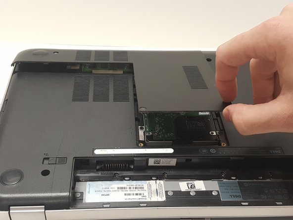

    • The screws do not come out of the access door. Do not try to remove them.
    • Loosen the 3 screws on the access door using the 2.0mm phillips head screwdriver.
    • Remove the access door.

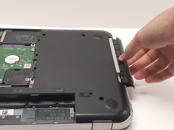

    • Remove the disk drive screw using the 2.0mm phillips head screwdriver.
    • Remove the disk drive from the laptop.
    • Remove the 2 screws under the disk drive with the 2.0mm phillips head screwdriver.

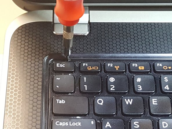

    • Depress the keyboard latches to release the keyboard with the 2.0mm flat head screwdriver.
    • Lift the keyboard up carefully.
    • Release the two ribbon cables underneath the keyboard.

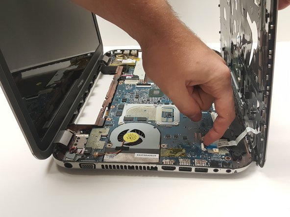

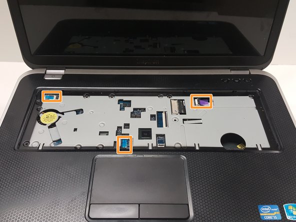

  8. Dell Inspiron 15r 7520 AC/DC Power Jack Plug Socket Replacement: crwdns2935265:08crwdnd2935265:01crwdnd2935265:02crwdne2935265:0 Dell Inspiron 15r 7520 AC/DC Power Jack Plug Socket Replacement: crwdns2935265:08crwdnd2935265:02crwdnd2935265:02crwdne2935265:0
    • Remove the 6 palm rest screws using the 2.0mm phillips head screwdriver.
    • Unplug the 3 ribbon cables.

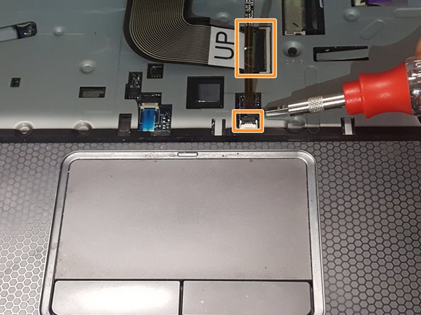

  9. Dell Inspiron 15r 7520 AC/DC Power Jack Plug Socket Replacement: crwdns2935265:09crwdnd2935265:01crwdnd2935265:03crwdne2935265:0 Dell Inspiron 15r 7520 AC/DC Power Jack Plug Socket Replacement: crwdns2935265:09crwdnd2935265:02crwdnd2935265:03crwdne2935265:0 Dell Inspiron 15r 7520 AC/DC Power Jack Plug Socket Replacement: crwdns2935265:09crwdnd2935265:03crwdnd2935265:03crwdne2935265:0

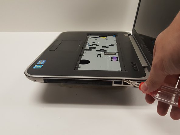

    • Take your time on this step and be careful to not break the plastic palm rest.
    • Separate the palm rest from the bottom base using the 2.0mm flat head screwdriver as a lever.
    • Unplug the ribbon cable underneath the palm rest.

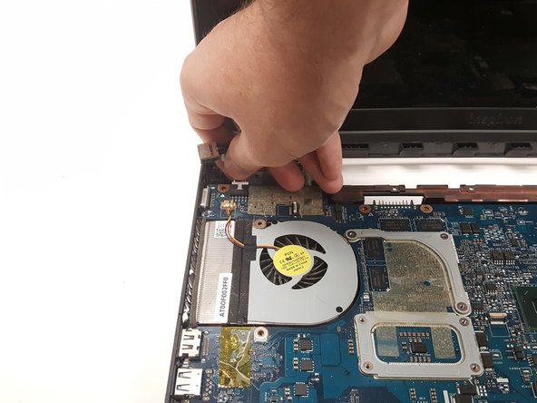

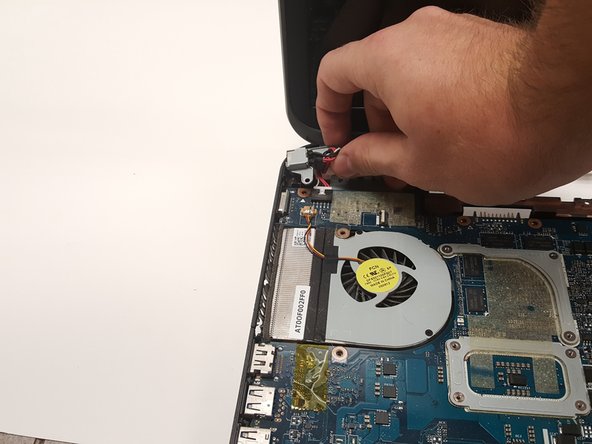

    • Remove the 2 DC jack bracket screws with the 2.0mm phillips head screwdriver and remove the bracket.
    • Unplug and remove the old DC jack.
Follow these instructions in reverse order to reassemble your device.
