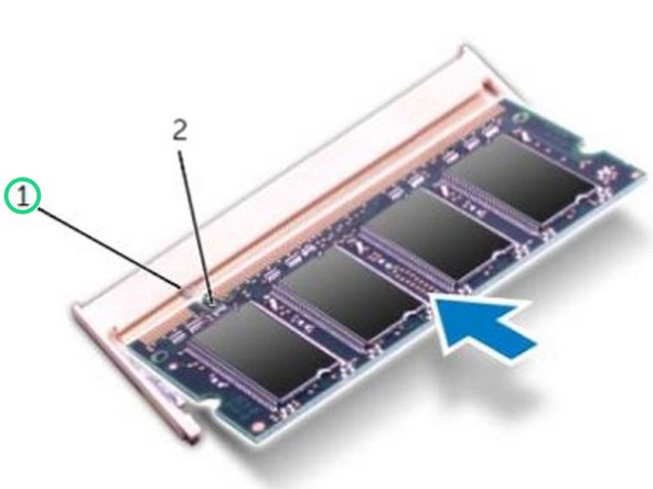

  3. Dell Inspiron 15R SE 7520 Memory Module Replacement, Align the Notch: crwdns2935265:03crwdnd2935265:01crwdnd2935265:02crwdne2935265:0 Dell Inspiron 15R SE 7520 Memory Module Replacement, Align the Notch: crwdns2935265:03crwdnd2935265:02crwdnd2935265:02crwdne2935265:0
    • Align the notch on the NEW memory module with the tab on the memory-module connector.
  4. Dell Inspiron 15R SE 7520 Memory Module Replacement, Sliding the Memory Module: crwdns2935265:04crwdnd2935265:01crwdnd2935265:01crwdne2935265:0
    • Slide the memory module firmly into the slot at a 45-degree angle, and press the memory module down until it clicks into place. If you do not hear the click, remove the memory module and reinstall it.
    • NOTE: If the memory module is not installed properly, the computer may not boot.
