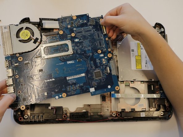

  28. Dell Inspiron 15R 5537 Motherboard Replacement, Motherboard: crwdns2935265:029crwdnd2935265:01crwdnd2935265:03crwdne2935265:0 Dell Inspiron 15R 5537 Motherboard Replacement, Motherboard: crwdns2935265:029crwdnd2935265:02crwdnd2935265:03crwdne2935265:0 Dell Inspiron 15R 5537 Motherboard Replacement, Motherboard: crwdns2935265:029crwdnd2935265:03crwdnd2935265:03crwdne2935265:0
    • Unplug the speaker cable.

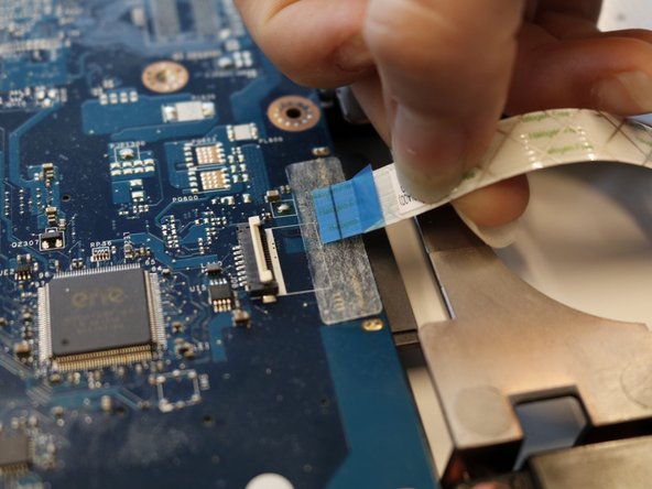

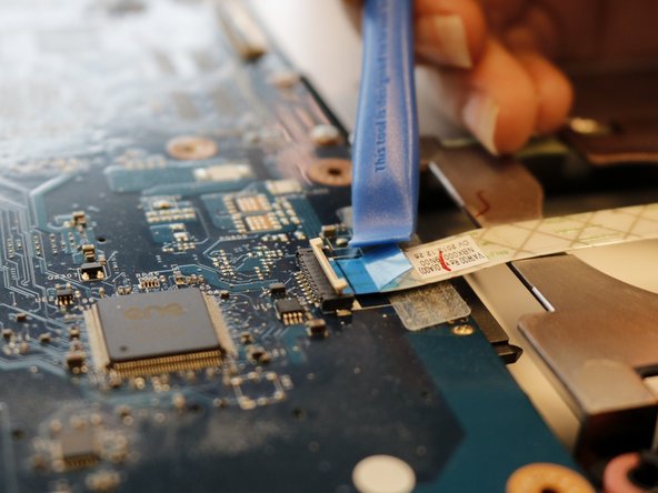

  29. Dell Inspiron 15R 5537 Motherboard Replacement: crwdns2935265:030crwdnd2935265:01crwdnd2935265:03crwdne2935265:0 Dell Inspiron 15R 5537 Motherboard Replacement: crwdns2935265:030crwdnd2935265:02crwdnd2935265:03crwdne2935265:0 Dell Inspiron 15R 5537 Motherboard Replacement: crwdns2935265:030crwdnd2935265:03crwdnd2935265:03crwdne2935265:0
    • Remove the cable running over the hard drive by using the opening tool to lift the tab and pull back.
  30. Dell Inspiron 15R 5537 Motherboard Replacement: crwdns2935265:031crwdnd2935265:01crwdnd2935265:01crwdne2935265:0
    • Remove the single 5mm Phillips #000 screw.
  31. Dell Inspiron 15R 5537 Motherboard Replacement: crwdns2935265:032crwdnd2935265:01crwdnd2935265:03crwdne2935265:0 Dell Inspiron 15R 5537 Motherboard Replacement: crwdns2935265:032crwdnd2935265:02crwdnd2935265:03crwdne2935265:0 Dell Inspiron 15R 5537 Motherboard Replacement: crwdns2935265:032crwdnd2935265:03crwdnd2935265:03crwdne2935265:0
    • Remove the motherboard by lifting straight up. Ensure the CD drive is disconnected from the motherboard.
