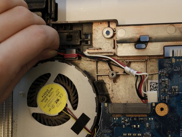

    • Unplug the DC jack to the right of the fan.
  23. Dell Inspiron 15R 5537 DC Jack Replacement: crwdns2935265:024crwdnd2935265:01crwdnd2935265:03crwdne2935265:0 Dell Inspiron 15R 5537 DC Jack Replacement: crwdns2935265:024crwdnd2935265:02crwdnd2935265:03crwdne2935265:0 Dell Inspiron 15R 5537 DC Jack Replacement: crwdns2935265:024crwdnd2935265:03crwdnd2935265:03crwdne2935265:0
    • Unplug the display cable below the fan by pulling the cable straight back.
  24. Dell Inspiron 15R 5537 DC Jack Replacement: crwdns2935265:025crwdnd2935265:01crwdnd2935265:03crwdne2935265:0 Dell Inspiron 15R 5537 DC Jack Replacement: crwdns2935265:025crwdnd2935265:02crwdnd2935265:03crwdne2935265:0 Dell Inspiron 15R 5537 DC Jack Replacement: crwdns2935265:025crwdnd2935265:03crwdnd2935265:03crwdne2935265:0
    • Unplug the display cable located near the right display hinge by lifting the tape and pulling back.
  25. Dell Inspiron 15R 5537 DC Jack Replacement: crwdns2935265:026crwdnd2935265:01crwdnd2935265:03crwdne2935265:0 Dell Inspiron 15R 5537 DC Jack Replacement: crwdns2935265:026crwdnd2935265:02crwdnd2935265:03crwdne2935265:0 Dell Inspiron 15R 5537 DC Jack Replacement: crwdns2935265:026crwdnd2935265:03crwdnd2935265:03crwdne2935265:0
    • Remove the two 5mm Phillips #000 screws from the left and right hinges.
  26. Dell Inspiron 15R 5537 DC Jack Replacement: crwdns2935265:027crwdnd2935265:01crwdnd2935265:02crwdne2935265:0 Dell Inspiron 15R 5537 DC Jack Replacement: crwdns2935265:027crwdnd2935265:02crwdnd2935265:02crwdne2935265:0
    • Remove the display assembly by lifting the display from the hinges.
    • It is important to ensure the display cables are fully disconnected before removing the assembly.

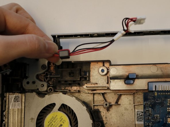

  27. Dell Inspiron 15R 5537 DC Jack Replacement, DC Jack: crwdns2935265:028crwdnd2935265:01crwdnd2935265:03crwdne2935265:0 Dell Inspiron 15R 5537 DC Jack Replacement, DC Jack: crwdns2935265:028crwdnd2935265:02crwdnd2935265:03crwdne2935265:0 Dell Inspiron 15R 5537 DC Jack Replacement, DC Jack: crwdns2935265:028crwdnd2935265:03crwdnd2935265:03crwdne2935265:0
    • Remove the DC jack once the display is removed by pulling the cable assembly upwards.
