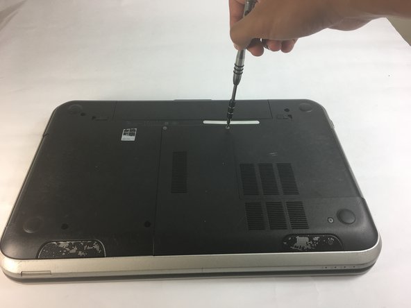

    • Locate and loosen the three 3 mm screws.
    • Remove the plastic casing with the screws attached.

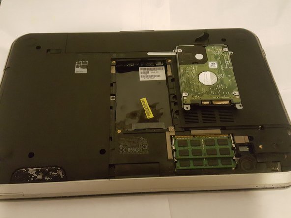

    • Locate and remove the four 4mm screws holding the hard drive in place.
  5. Dell Inspiron 15R 5520 Hard Drive Replacement: crwdns2935265:05crwdnd2935265:01crwdnd2935265:03crwdne2935265:0 Dell Inspiron 15R 5520 Hard Drive Replacement: crwdns2935265:05crwdnd2935265:02crwdnd2935265:03crwdne2935265:0 Dell Inspiron 15R 5520 Hard Drive Replacement: crwdns2935265:05crwdnd2935265:03crwdnd2935265:03crwdne2935265:0

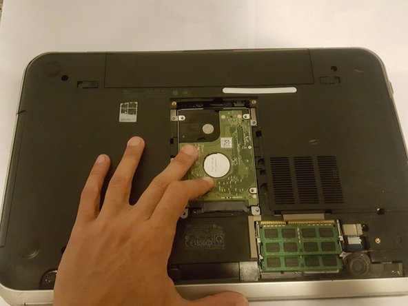

    • Push the hard drive horizontally and away from yourself.
  6. Dell Inspiron 15R 5520 Hard Drive Replacement: crwdns2935265:06crwdnd2935265:01crwdnd2935265:02crwdne2935265:0 Dell Inspiron 15R 5520 Hard Drive Replacement: crwdns2935265:06crwdnd2935265:02crwdnd2935265:02crwdne2935265:0
    • Lift the hard drive up and out of the bay.

I have a Dell 15R 5537. The drive removal is about the same. There are only two screws holding the drive, though. They’re located at the back of the drive. Push the drive back to clear the connector and pull up aided by a clear plastic pull tab on the drive.
Adrian Kocurek - crwdns2934203:0crwdne2934203:0
It worked and was well worth installing an SSD.
