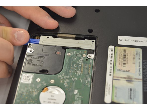

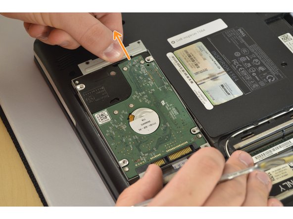

    • Removing the Hard Drive
    • Unscrew the four screws holding in the hard drive.
    • Slide the hard drive towards and to the left to unplug it.
    • Pry the hard drive upwards and pull away from device.

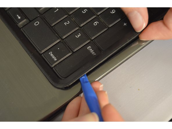

    • Removing Keyboard Cover
    • Be careful to not pull on the ribbon cable that connects the keyboard to the computer.
    • Using the blue plastic opening tool, start prying in the space between the screen and the keyboard.
    • Remove black cover from the keyboard.

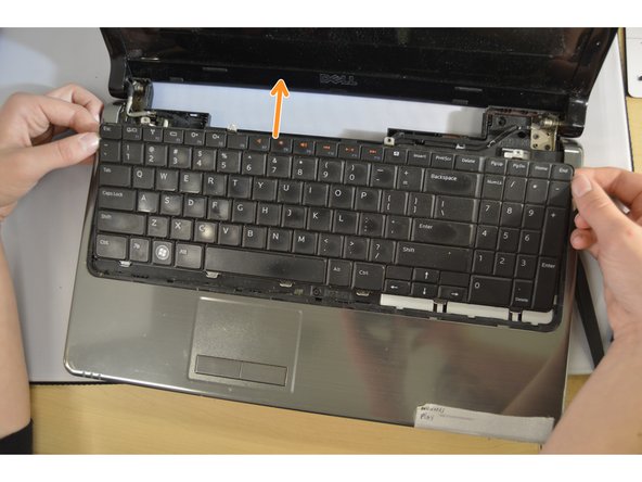

    • Removing Keyboard
    • Remove the four screws on the top of the keyboard.
    • Press down on the tabs on each side of the keyboard to free it.
    • In the next part, there is a wire connected to the bottom of the keyboard, and if you pull the keyboard up too fast it will break.
    • Remove the keyboard by pulling the board towards the screen and up.

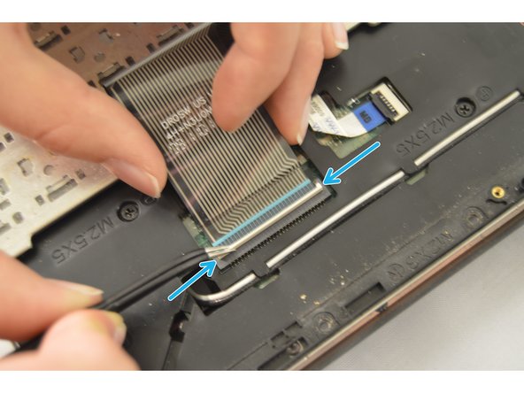

    • Flip the latch on the computer connecting the ribbon cable to the keyboard.
  8. Dell Inspiron 1564 CPU Fan Replacement: crwdns2935265:08crwdnd2935265:01crwdnd2935265:02crwdne2935265:0 Dell Inspiron 1564 CPU Fan Replacement: crwdns2935265:08crwdnd2935265:02crwdnd2935265:02crwdne2935265:0
    • Removing Keyboard Continued
    • Slide the keyboard ribbon cable out.

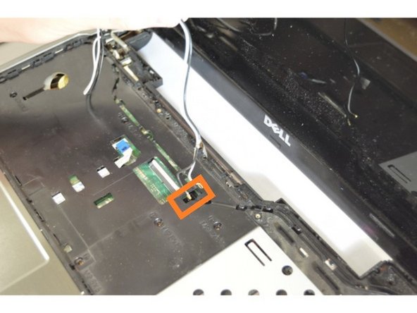

    • Removing Wireless Card Cables
    • In the next part, be careful to not rip black and white wire.
    • Turn device upside-down.
    • Remove black and white wires from wireless card.
  10. Dell Inspiron 1564 CPU Fan Replacement: crwdns2935265:010crwdnd2935265:01crwdnd2935265:02crwdne2935265:0 Dell Inspiron 1564 CPU Fan Replacement: crwdns2935265:010crwdnd2935265:02crwdnd2935265:02crwdne2935265:0
    • Removing Wireless Card Cables Continued
    • Lift black and white wire connections away from the device.
    • Slide wires through the hole to the top of the keyboard.

It's a nice guide to disassemble the notebook correctly, but I would like to add more precise pictures at some steps. At step 9 for example you wrote to lift up the cables for sliding wires through a hole in the couvering plate. Here it was useful to show with a coloured circle where to locate this. In the last step you added a wrong picture. The second image shows the wireless card and how to disconnect it's cables instead the fan's connector. But apart from that this guide was useful (sorry for possible language mistakes) :-)

Now i’m assuming that this is because my computer has been used quite a bit, but in step 8, my ribbon cable fell apart. it is currently held together with electrical tape and prayers. so if anyone would want to not have that happen, I suggest removing the power button and tucking it away instead.
