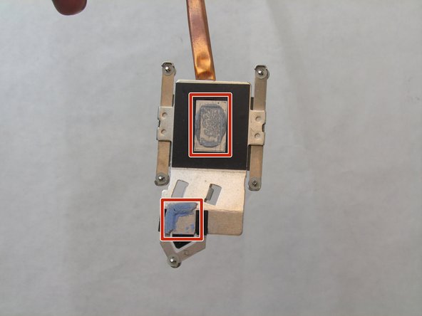

  3. Dell Inspiron 1526 Heat Sink Replacement: crwdns2935265:03crwdnd2935265:01crwdnd2935265:02crwdne2935265:0 Dell Inspiron 1526 Heat Sink Replacement: crwdns2935265:03crwdnd2935265:02crwdnd2935265:02crwdne2935265:0
    • Loosen the five captive Phillips #0 screws from the heat sink.
    • Lift the heat sink from the motherboard.
  4. Dell Inspiron 1526 Heat Sink Replacement: crwdns2935265:04crwdnd2935265:01crwdnd2935265:02crwdne2935265:0 Dell Inspiron 1526 Heat Sink Replacement: crwdns2935265:04crwdnd2935265:02crwdnd2935265:02crwdne2935265:0
    • Apply a pea-sized amount of new thermal paste to the CPU and GPU.
