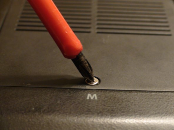

    1. Dell Inspiron 1521 RAM Replacement, RAM: crwdns2935265:03crwdnd2935265:01crwdnd2935265:02crwdne2935265:0 Dell Inspiron 1521 RAM Replacement, RAM: crwdns2935265:03crwdnd2935265:02crwdnd2935265:02crwdne2935265:0
      • Locate the Phillips #1 screw securing panel M.
      • Remove the screw from panel M with a Phillips #1 screwdriver.
    2. Dell Inspiron 1521 RAM Replacement: crwdns2935265:04crwdnd2935265:01crwdnd2935265:03crwdne2935265:0 Dell Inspiron 1521 RAM Replacement: crwdns2935265:04crwdnd2935265:02crwdnd2935265:03crwdne2935265:0 Dell Inspiron 1521 RAM Replacement: crwdns2935265:04crwdnd2935265:03crwdnd2935265:03crwdne2935265:0
      • Pry the panel open with the plastic opening tool.
      • Gently pull with your fingers to remove the panel.
