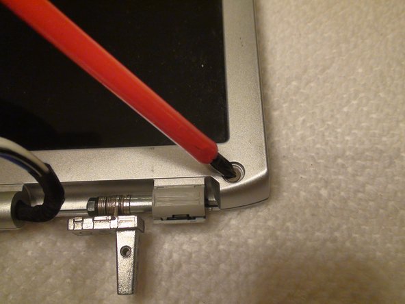

    • Locate the six 5 mm Phillips #1 screws connecting the display bezel to the back cover.
    • If there are mylar screw covers or rubber bumpers covering the screws remove them.
    • Remove the six screws with a Phillips #1 screwdriver.

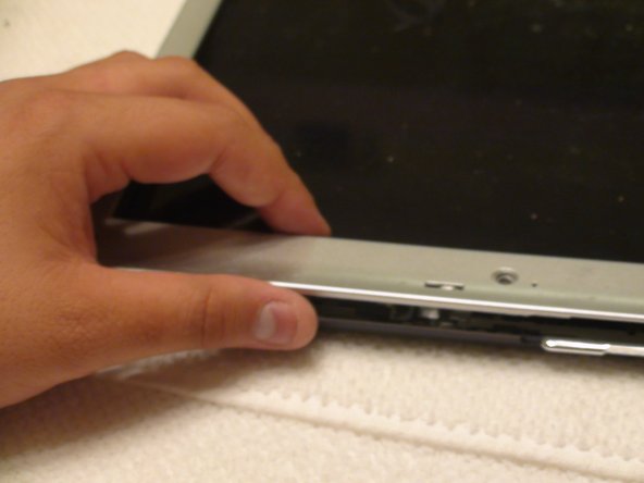

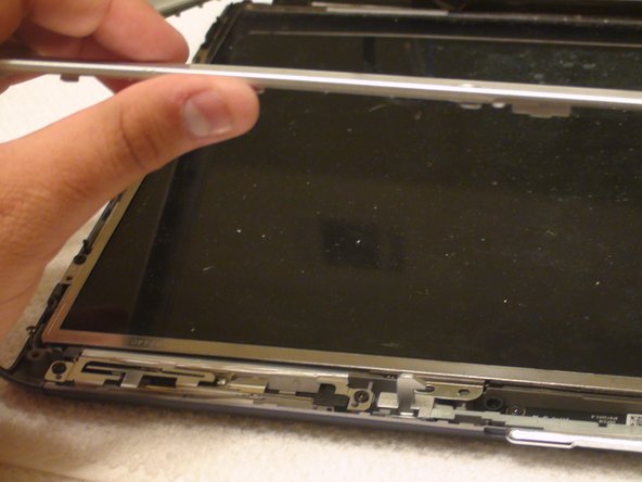

    • When removing the bezel be careful not to damage it. Removal should be done gently and slowly.
    • Use a plastic opener tool to begin separating the bezel from the display assembly.
    • Move around the edges of the bezel with your hand or a plastic opener tool in order to loosen it from the display assembly.
    • Once the bezel is loose, remove it from the display assembly by hand.

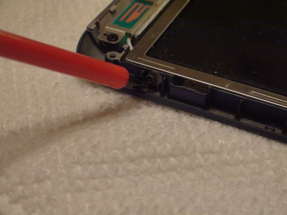

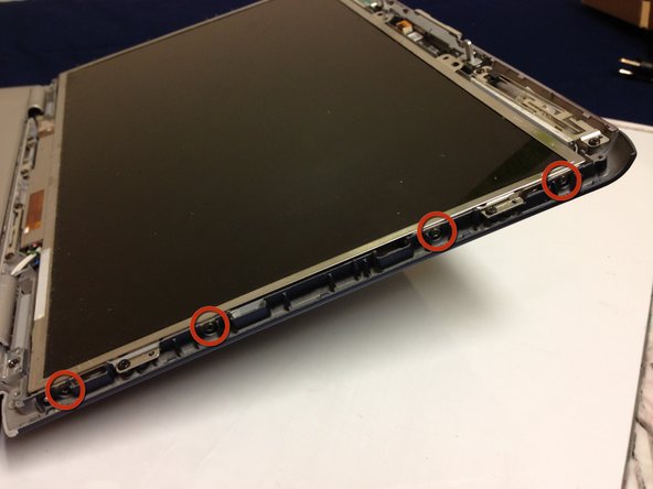

    • Locate the eight 4 mm Phillips #1 screws (four on each side of the LCD) that secure the display to the assembly.
    • Remove the eight screws with a Phillips #1 screwdriver.

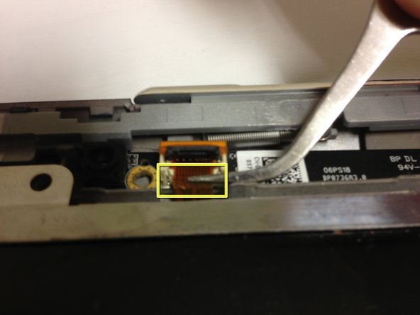

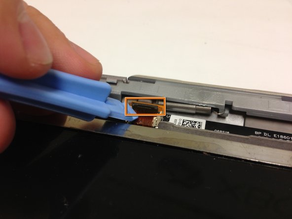

    • The LCD display can not be completely removed until the cable attached to the assembly is disconnected.
    • Locate where the LCD display cable connects to the housing.
    • Lift the black tab with your finger or a plastic opener tool.
    • Gently pull on the cable with tweezers to disconnect it.
