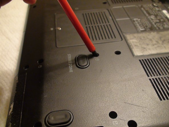

  3. Dell Inspiron 1521 Hard Drive Replacement, Hard Drive: crwdns2935265:03crwdnd2935265:01crwdnd2935265:02crwdne2935265:0 Dell Inspiron 1521 Hard Drive Replacement, Hard Drive: crwdns2935265:03crwdnd2935265:02crwdnd2935265:02crwdne2935265:0
    • Locate the four 4 mm Phillips #1 screws that secure the hard drive to the laptop. Each of the screws has a white cylinder next to it.
    • Remove these four screws with a Phillips #1 screwdriver.

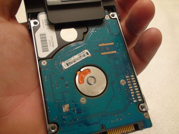

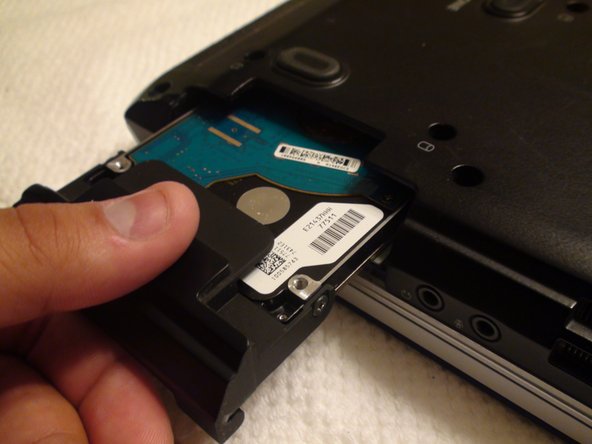

  4. Dell Inspiron 1521 Hard Drive Replacement: crwdns2935265:04crwdnd2935265:01crwdnd2935265:03crwdne2935265:0 Dell Inspiron 1521 Hard Drive Replacement: crwdns2935265:04crwdnd2935265:02crwdnd2935265:03crwdne2935265:0 Dell Inspiron 1521 Hard Drive Replacement: crwdns2935265:04crwdnd2935265:03crwdnd2935265:03crwdne2935265:0
    • Once you've made sure all four screws are removed slide the hard drive out with your hand.
