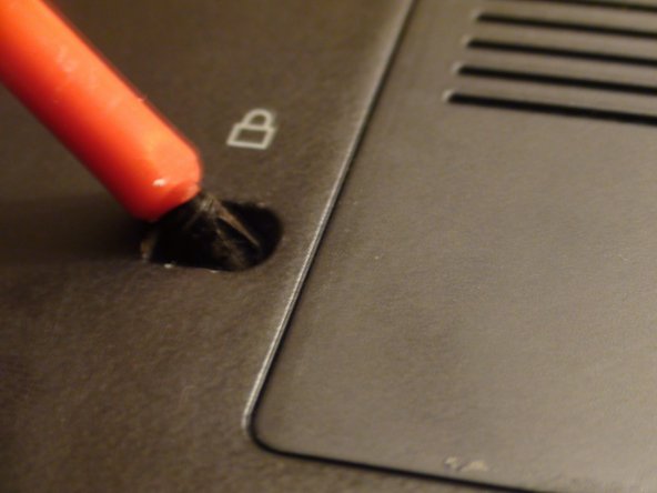

  3. Dell Inspiron 1521 DVD Drive Replacement, DVD Drive: crwdns2935265:03crwdnd2935265:01crwdnd2935265:02crwdne2935265:0 Dell Inspiron 1521 DVD Drive Replacement, DVD Drive: crwdns2935265:03crwdnd2935265:02crwdnd2935265:02crwdne2935265:0
    • Locate the 4 mm Phillips #1 screw next to the white padlock image that holds the DVD drive in place.
    • Remove this screw with a Phillips #1 screwdriver.
  4. Dell Inspiron 1521 DVD Drive Replacement: crwdns2935265:04crwdnd2935265:01crwdnd2935265:03crwdne2935265:0 Dell Inspiron 1521 DVD Drive Replacement: crwdns2935265:04crwdnd2935265:02crwdnd2935265:03crwdne2935265:0 Dell Inspiron 1521 DVD Drive Replacement: crwdns2935265:04crwdnd2935265:03crwdnd2935265:03crwdne2935265:0
    • Use a plastic opener tool to carefully pry the DVD drive out of its pocket on the side of the laptop.
    • Once sticking out, pull the DVD drive the rest of the way out with your hand.
