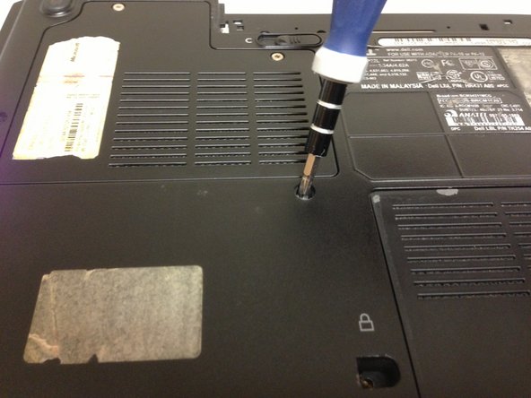

    • Locate the thirteen 10 mm Phillips #1 screws securing the bottom panel of the laptop.
    • Remove the thirteen indicated screws with a Phillips #1 screwdriver.
    • With the screws removed you can now remove the panel underneath keyboard.
