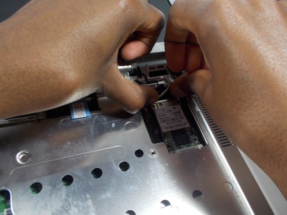

  5. Dell Inspiron 1501 Wireless Mini-Card Replacement, Wireless Mini-Card: crwdns2935265:05crwdnd2935265:01crwdnd2935265:02crwdne2935265:0 Dell Inspiron 1501 Wireless Mini-Card Replacement, Wireless Mini-Card: crwdns2935265:05crwdnd2935265:02crwdnd2935265:02crwdne2935265:0
    • Remove the two wires from their connections.
    • Pull the metal tabs securing the wireless mini-card to the back of the laptop until the card pops up.
    • Remove the wireless mini-card from the laptop.
