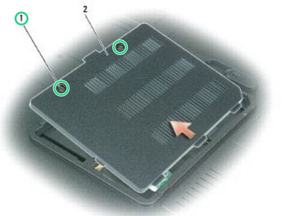

  2. Dell Inspiron 1501 Memory Modules Replacement, Loosen the Screws: crwdns2935265:02crwdnd2935265:01crwdnd2935265:01crwdne2935265:0
    • Loosen the two captive screws on the memory module/modem cover and remove the cover.

  7. Dell Inspiron 1501 Memory Modules Replacement, Replace the Modem Cover: crwdns2935265:07crwdnd2935265:01crwdnd2935265:02crwdne2935265:0 Dell Inspiron 1501 Memory Modules Replacement, Replace the Modem Cover: crwdns2935265:07crwdnd2935265:02crwdnd2935265:02crwdne2935265:0
    • Replace the memory module/modem cover and tighten the captive screws.
    • NOTICE: If the memory module/modem cover is difficult to close, remove the module and reinstall it. Forcing the cover to close may damage your computer.
