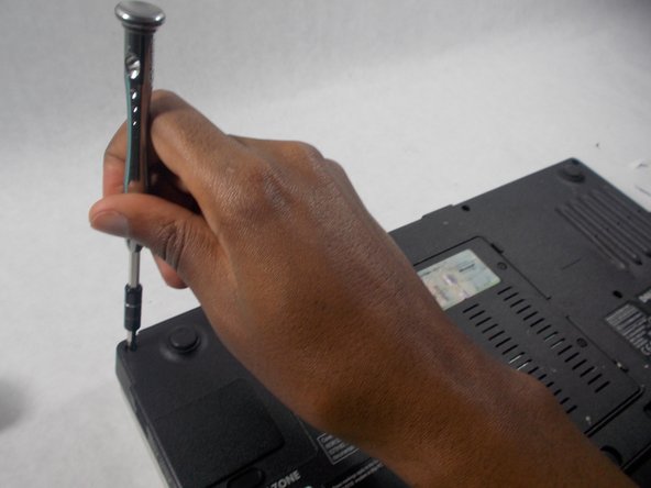

  6. Dell Inspiron 1501 Display Replacement: crwdns2935265:06crwdnd2935265:01crwdnd2935265:01crwdne2935265:0
    • From the back of the computer, remove the two screw covers.
    • Remove the two 8mm JIS #1 screws.

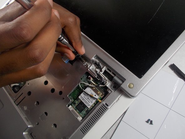

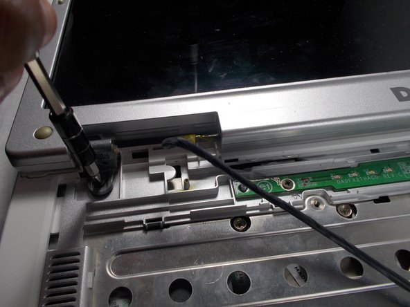

  7. Dell Inspiron 1501 Display Replacement: crwdns2935265:07crwdnd2935265:01crwdnd2935265:02crwdne2935265:0 Dell Inspiron 1501 Display Replacement: crwdns2935265:07crwdnd2935265:02crwdnd2935265:02crwdne2935265:0
    • Turn the laptop over and open the display.
    • Remove the two 5mm JIS #1 screws on the display hinge.

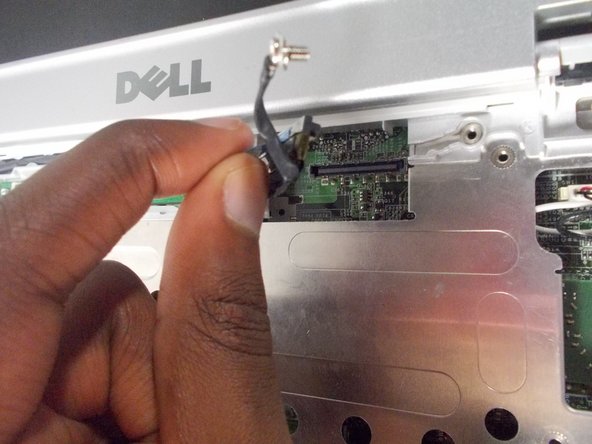

  8. Dell Inspiron 1501 Display Replacement: crwdns2935265:08crwdnd2935265:01crwdnd2935265:03crwdne2935265:0 Dell Inspiron 1501 Display Replacement: crwdns2935265:08crwdnd2935265:02crwdnd2935265:03crwdne2935265:0 Dell Inspiron 1501 Display Replacement: crwdns2935265:08crwdnd2935265:03crwdnd2935265:03crwdne2935265:0
    • Disconnect the antenna cables from the Mini-Card.
    • Be careful not to knock the standby switch when disconnecting the cables as it is easily broken.
    • Loosen the JIS #1 screw on the display cable.
    • Pull the pull-tab straight up to disconnect the display cable from the laptop.
