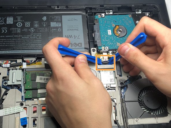

  7. Dell Inspiron 15-7567 Hard Drive Replacement, Hard Drive: crwdns2935265:07crwdnd2935265:01crwdnd2935265:02crwdne2935265:0 Dell Inspiron 15-7567 Hard Drive Replacement, Hard Drive: crwdns2935265:07crwdnd2935265:02crwdnd2935265:02crwdne2935265:0
    • Remove the four 5mm screws with a Phillips #1 screwdriver.
  8. Dell Inspiron 15-7567 Hard Drive Replacement: crwdns2935265:08crwdnd2935265:01crwdnd2935265:03crwdne2935265:0 Dell Inspiron 15-7567 Hard Drive Replacement: crwdns2935265:08crwdnd2935265:02crwdnd2935265:03crwdne2935265:0 Dell Inspiron 15-7567 Hard Drive Replacement: crwdns2935265:08crwdnd2935265:03crwdnd2935265:03crwdne2935265:0
    • Remove the cable from the motherboard that is attached to the Hard Drive.
    • Use your fingers or the plastic opening tools to gently pull up on the clip, freeing the cable.

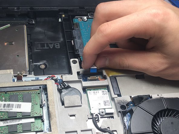

  9. Dell Inspiron 15-7567 Hard Drive Replacement: crwdns2935265:09crwdnd2935265:01crwdnd2935265:01crwdne2935265:0
    • Lift and remove Hard Drive.
