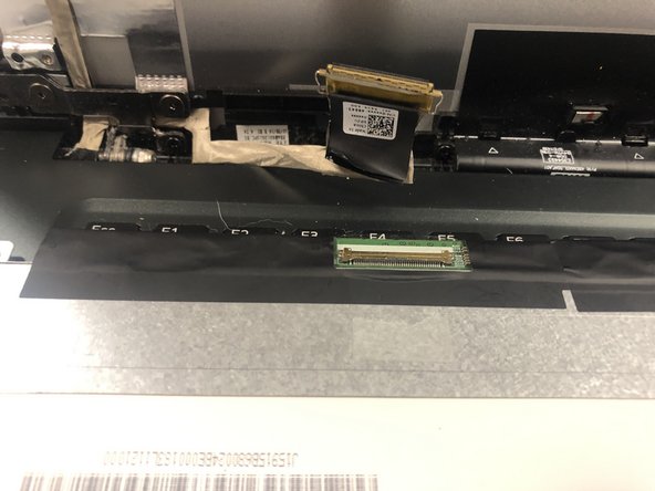

  8. Dell Inspiron 15-7548 Display Replacement, Disconnect LCD cable: crwdns2935265:08crwdnd2935265:01crwdnd2935265:02crwdne2935265:0 Dell Inspiron 15-7548 Display Replacement, Disconnect LCD cable: crwdns2935265:08crwdnd2935265:02crwdnd2935265:02crwdne2935265:0
    • Once the LCD is removed from the frame and has been set on the keyboard, peel back the black adhesive, which will reveal the LCD connector.
    • Flip the silver tab (blue arrow) and disconnect the cable (Orange Circle) from the old LCD.
    • Once removed, discard the old LCD and prepare the new LCD for installation. (remove from wrap, etc)
