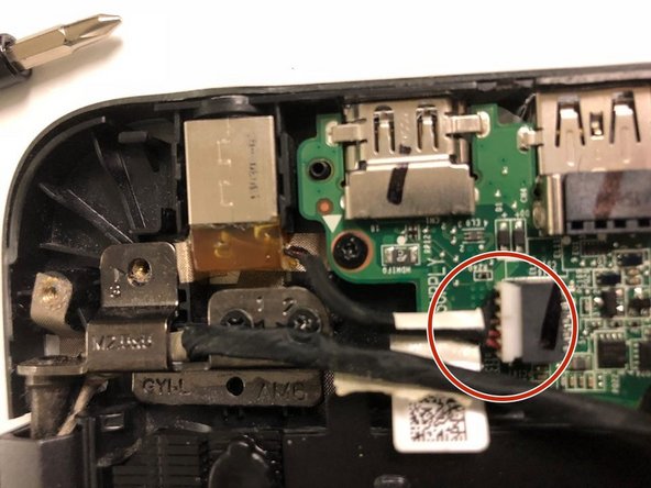

  3. Dell Inspiron 15-7548  Power Port Replacement, Power Port: crwdns2935265:03crwdnd2935265:01crwdnd2935265:02crwdne2935265:0 Dell Inspiron 15-7548  Power Port Replacement, Power Port: crwdns2935265:03crwdnd2935265:02crwdnd2935265:02crwdne2935265:0
    • Grab the wires and lightly pull to remove the power port from the motherboard.
